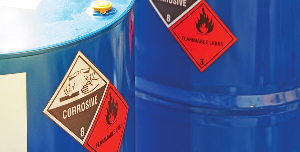

Drums containing corrosive, flammable liquid (Images courtesy of Finish Thompson)

What chemicals are being transferred?
Many applications involve harsh chemicals like acids and bases. Will the fluid that the pump will transfer be flammable or combustible? To ensure safe transfer, the appropriate materials must be selected.

If the material to be pumped is a flammable or combustible liquid, extra care is required. The pump, motor and accessories all need to be suitable for use with flammable/combustible fluids and use in hazardous locations.
