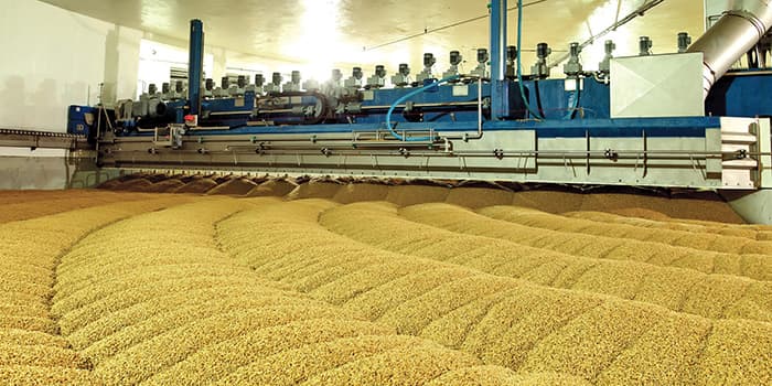

Extra precautions are needed in combustible environments such as grain handling and processing facilities.
