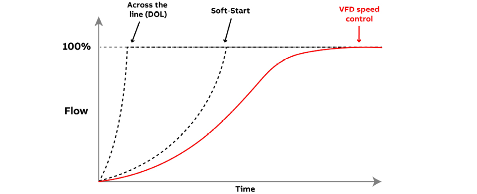

First, VFDs have the ability to utilize multiple ramps to slowly start a pump. Doing so is critical, as it reduces turbidity in drinking water while still starting fast enough to protect the motors, bearings and pumps. Because motors and pumps are typically designed to be at half speed in 1-3 seconds, secondary ramps are utilized to open/close check valves once the pump creates the flow/pressure required to open the valve. One additional reason to ramp the pump up to speed is to reduce or eliminate water hammer, thus reducing leaks, breaks and expensive spills that can risk permits and license compliance, all while extending the life of pipes and pumps.

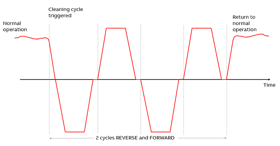

IMAGE 1: Pump clean process showing forward and reverse operation to clean impeller from rags and debris (Images courtesy of ABB)
IMAGE 2: Flow control for a slow ramp-up to extend pipe life, protect aging infrastructure and reduce water hammer
water hammer

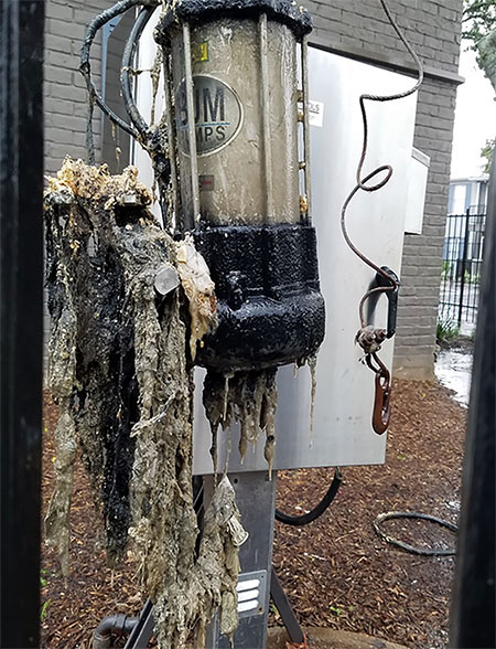

VFDs also come equipped with features to initiate pump impeller cleaning. VFDs offer the ability to locally on demand, remotely or automatically clean rags, debris or solids buildup from the impeller by quickly turning it and, when allowed, doing so in a forward/reverse rotation cycle of the impeller to dislodge the buildup (Image 1). By detecting a drop in performance or increase load on the pump, the VFD can be programmed to respond and clean the impeller, reducing the risk of damage to the pump due to lodged debris.
Flow control is an additional feature VFDs have built-in to safeguard pumping systems. Flow control maintains minimum flows to keep solids suspended or pipe flush to clear a pipe of solids. It also can keep flow on the low side to ensure the equipment is not operating outside its minimum speeds for cooling, lubrication and operation for the pump seals. By dynamically changing the pump’s speed to maintain the desired flow, the pump operates more efficiently, reducing mechanical stress and energy usage. It also helps prevent issues such as overpressure and system strain, improving overall system performance.

IMAGE 3: Blocked impeller from rags and debris that needs a pump clean
The VFD can quickly be programmed to operate the pump and maintain the required pressure, reducing the risk of system instability due to fluctuating flow, overpressure or cavitation. This will work for pressure, level, dissolved oxygen, flow and additional parameters.
