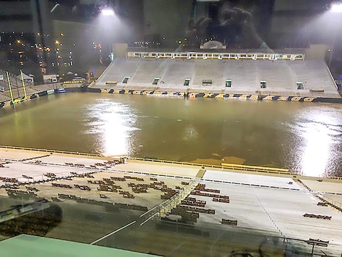

The game was scheduled for Saturday, Oct. 14, but torrential rain pounded the city of Kalamazoo, Michigan that afternoon. The 78-year-old stadium is in a flood plain and has three pumps that eject water to a 60-inch concrete pipe that Arcadia Creek flows through.
There were several catch basin inlets by the stadium that also drained to the 60-inch stormwater line. The line was at capacity, so stormwater moved backward and pushed water back around the stadium, contributing to the field flooding.
The creek was flooded. Eventually, water backed up and there were two feet of standing water on the turf.
After the adjacent baseball field couldn’t hold any more water, the first floor of the connecting Bill Brown Alumni Football Center began to flood. At that point, Peter Strazdas, WMU’s associate vice president for facilities management, made the decision to turn off the three pumps to keep the building from flooding more.

But WMU needed help. Clean Earth provided four vector trucks and two large tanker trucks to transport the water elsewhere on campus. The effort was halted at 2:30 a.m. when another deluge put 12 inches of water on the field. That passed and, at 5:30 a.m., the entire turf was visible.
There were five rips on the turf that were seamed and rubber palates on the turf that were repositioned, but the field was deemed safe at 8 a.m.
