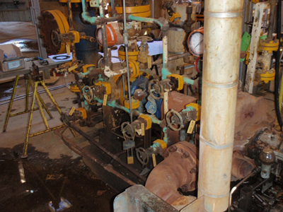

Figure 1. Old piping layout
To help mitigate potential seal leakage to the atmosphere, the low-pressure side of each seal was connected to the unit's flare header. Additionally, a low-pressure nitrogen purge was added to each mechanical seal a few years prior in an effort to dilute the primary seal leakage and lower detectable emissions to the atmosphere.
While the system functioned adequately for several years, reliability issues were associated with several of the pumps specifically related to inadequacies of the external flush supply source, resulting in premature seal failures in the majority of these services.
In some extreme cases, the average mean time between repair (MTBR) of the mechanical seals was six months. In addition, the interconnecting seal flush and vent to flare piping around each mechanical seal was hard piped with flanged joints. This configuration made access to each pump for day-to-day maintenance and condition monitoring extremely difficult.

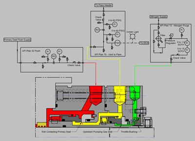

The mechanical seal design uses a wet contacting seal as its primary seal, a non-contacting, I.D. pressurized, outward pumping gas seal as its secondary seal and a segmented carbon throttle bushing as a final seal between the outboard seal and the atmosphere. The API Flush Plan designation for this seal support system is categorized as an API Plan 32 / 72 / 76. In this configuration, the primary seal is exposed to the process fluid, which in this case would be the external flush media (propane, isobutane, etc.).
The secondary seal is supported by a low pressure purge of nitrogen (Plan 72), with primary seal leakage vented to the unit's flare system (Plan 76). It is the specific design nuances of the proposed seal, particularly the use of spiral-groove seal face technology that makes the solution unique.

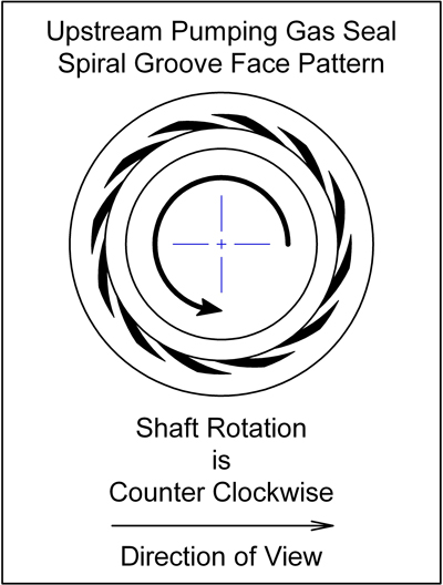

In normal operation, the flush leakage past the primary seal is sealed by the dry running, non-contacting seal that is designed to compress moisture-free nitrogen gas from the inside diameter to the outside diameter into the outboard cavity. The mixture of the nitrogen with the vaporized flush leakage is then vented to the unit's flare system. Nitrogen is supplied outboard of the dry tandem seal between the bushing, which restricts its flow.
The dry running seal faces incorporate a series of partial spiral grooves, which are designed to operate on a thin film of gas. The grooves are configured to pump from the inner diameter (ID) to the outer diameter (OD) of the seal faces. See Figure 2. The nitrogen quench supply ensures an inert spiral groove film, which results in a small amount of nitrogen leakage to the unit's flare system.
Figure 2. Spiral groove face pattern
Vapor leakage past the inboard seal under normal operating mode is completely isolated by the nitrogen quenched seal and cannot escape to the atmosphere. Therefore, all emissions are directed to the flare system through the gland vent. An inclusion of an orifice in this vent line allows the restriction of more significant levels of leakage such that a pressure rise will result. A pressure switch between the seal and the orifice detects a pressure rise associated with primary seal failure should it occur.
Nitrogen leakage of the gas seal will enter the flare system header line through a vent in the gland plate while nitrogen leakage across the bushing will be released to the atmosphere. The bushing also serves as an additional containment seal in the unlikely event that both the primary and secondary seals fail. See Figure 3.

Seal support piping
Figure 3. Seal support piping
Prior to project implementation, maintenance and condition monitoring accessibility was limited. In mounting the bulk of the flush, nitrogen purge and vent to flare components for the mechanical seal away from the pump baseplate, the area around the pump was immediately made more accessible for routine maintenance and condition monitoring activities. See Figure 5.
