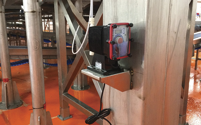

Metering Pump InstallationImage 1. An example of a metering pump installation (Images courtesy of the author)

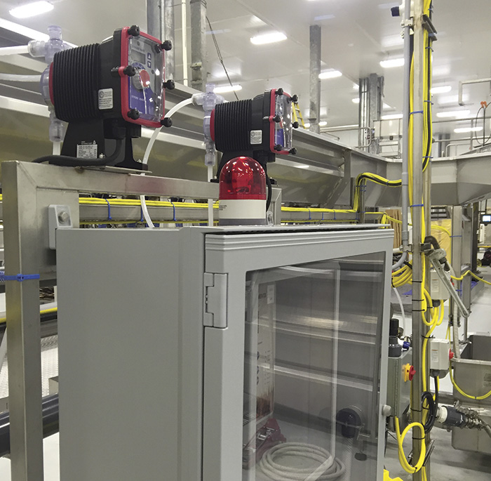

Metering PumpsImage 2. Metering pumps installed in a facility
The pumps can be moved to a dry location, but this makes it difficult to monitor the performance and make adjustments. The pump also may require lengthy runs of tubing, which can cause loss of prime and chemical feed.
One of the simplest solutions to this challenge is an IP 67-rated chemical metering pump. Manufacturing a pump to this specification is not an easy task, but some technology can meet the challenge. One company’s pump that has been in the produce processing market for more than six years has a complete gasket surrounding the cover, which mates with the faceplate to create a waterproof seal.
With this equipment, the glands used for wiring the pump are waterproof when used as described in the manual. In addition, the cabling used for control must have a tight fit to ensure it stays waterproof. If the cable diameter does not have a snug fit, water can seep into the drive.
The bolts on the cover plates also must be tight and in the correct position. It is advisable to tighten them diagonally to ensure that the seal has equal pressure on all sides.
All pumps must be secured, preferably to a bracket or a shelf. If a pump is placed on top of a chemical tank, it may be dislodged during washdown or when the tank is moved. This is probably the second leading cause of pump failures in food and beverage plants.

When pumping an oxidant that off-gasses, it is important to install an auto-degassing valve. This valve purges gases from the pump head through a low-pressure line so that the pump does not lose prime because of a vapor lock. The purge line returns to the chemical tank. Vapor lock occurs because gas is compressible and liquid is not.
When the pump is unable to purge the gas, the gas in the head is continually compressed and decompressed, so no liquid moves through the lines. It is always advisable to have the shortest suction line possible, so gas cannot accumulate. This will reduce the time required for the pump to purge the gas from the tubing, which will help keep the chemical residual consistent.
The pump also may be outfitted with a chemical feed verification device that will alert end users to the loss of chemical feed from the pump. The device sends a signal to a controller or programmable logic controller with an alarm when this deviation occurs.
