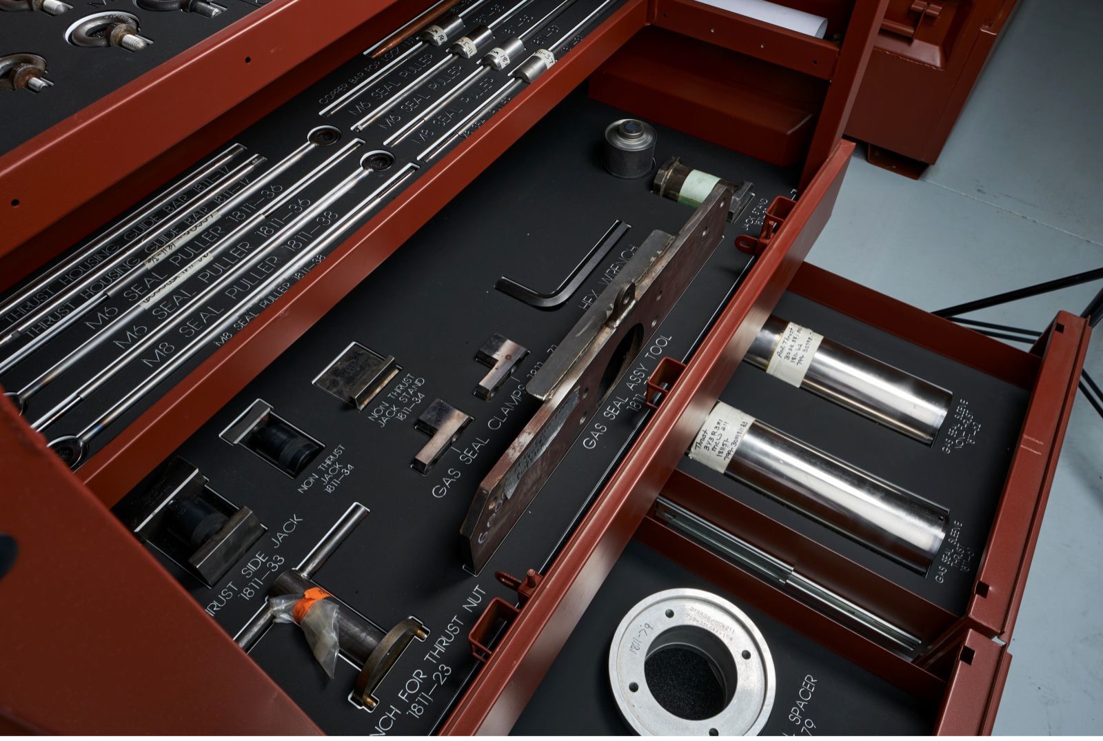

In industrial environments where uptime is critical, the success of planned outages often hinges on the availability and condition of spare parts and tools. Kit boxes—pre-assembled, organized containers of essential components and tooling—are becoming a best practice for ensuring readiness and reducing the risks associated with maintenance events and process upsets.
kit box
IMAGE 1: A well-organized kit box with labeled compartments for spare parts and tools (Images courtesy of ICON Industrial Group)

The Role of Kit Boxes
Kit boxes offer a structured solution to many material management challenges. They are typically assembled and inventoried well in advance of an outage to contain all the parts, tools and consumables required for specific equipment or systems. Each item is labeled, preserved and stored in a logical layout to facilitate quick access and verification.
Common Kit Box Contents:
  • Spare parts (seals, bearings, valves, linkages, fasteners)
  • Special tools (hydraulic pumps, lifting jigs, alignment tools)
  • Consumables (lubricants, sealants, cleaning agents)
  • Documentation (inspection reports, part specifications)
