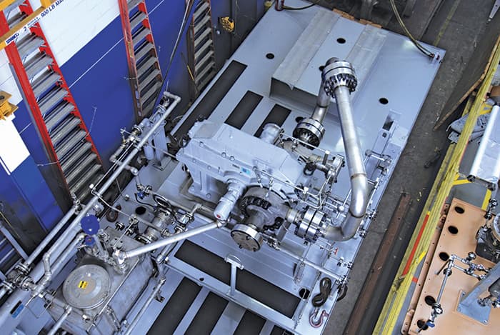

The production of purified terephthalic acid (PTA) poses unique challenges for centrifugal pumps. For increased safety and reliability, some facilities with this process have incorporated custom-engineered liquid-lubricated double seals. This new technology meets the ever-increasing product performance requirements of leading PTA producers. HP reactor feed pumps—in many cases, integrally geared high-speed centrifugal pumps—play a vital role in the purification stage of crude terephthalic acid (TA). These pumps deliver TA slurry, which contains TA powder suspended in demineralized water at a high temperature, into a hydrogenation reactor, where a reaction with hydrogen removes contaminants from the solution. PTA is the predominant raw material for production of high-purity polyester resin, which is widely used in the production of polyester fiber, polyethylene terephthalate (PET) bottle resin, polyester film and engineering plastics.

One of the main technical challenges in this application pertained to the barrier/buffer fluid. Instead of using the more common ambient-temperature demineralized water as a barrier/buffer liquid that is usually supplied from the PTA plant centralized seal-support system, the facility requested to use plant return water at the normal temperature of 70 degrees C (158 F), with a maximum temperature of 80 C (176 F). The potential problem with using plant return water as barrier/buffer liquid under these conditions is an adverse seal environment characterized by inadequate heat dissipation and poor lubrication of seal faces resulting from a loss of fluid film from vaporization. An additional technical challenge was reverse pressurization of the Stage 2 process side seal during pump startup and shutdown. During the startup sequence, this seal is reverse-pressurized by the buffer fluid introduced into the seal support system before the pump main driver is turned on. Under transient conditions, while the pump is ramping up to full speed and reaching full discharge pressure, the pressure applied to the seal is reversed, causing the seal to hang up. The same problem occurs in opposite order during pump coast down to shutdown. The original seal design was modified to incorporate new features to overcome seal hang-up associated with the secondary seal.
Optimized Design
Design improvements to the seal technology, including the use of ultra-high-performance materials, were made to guarantee stable running across the entire operating range. While the regular seals use silicon carbide ceramic material for both seal face and stationary seat, the stationary seal face for this application was based on the silicon carbide variant BuKa 30. This material has a high carbon content, making it an ideal solution for media with poor lubricating properties, such as water. BuKa 30 impresses with its effective emergency running properties and tolerance to dry running. The seal was further optimized to guarantee functional reliability, even in the marginal ranges. A loosely fitted seal face provides additional safety against tipping and tilting. Another technical feature of the high-pressure seal developed for the PTA application is the incorporation of high-precision grooves in the seal faces. The depth and geometry of these grooves were specified with accuracy. At low pressure, the grooves promote lift-off of the seal faces by creating a positive pressure cushion, and they quickly establish a stable operating state. At high pressure, the grooves have a stabilizing effect because they prevent the gap from opening further.
