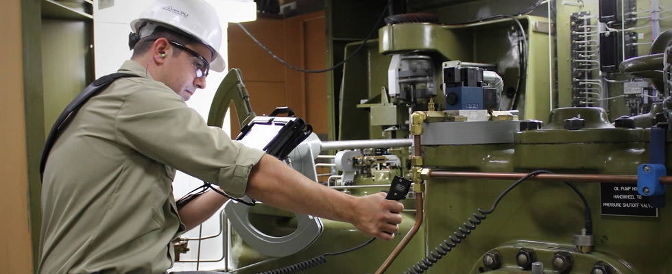

IMAGE 1: Technician collecting readings using a handheld vibration analyzer, also known as condition-based monitoring (Image courtesy of Fluke)

Condition monitoring can be done manually or automatically. Route-based monitoring, in which technicians collect readings monthly or quarterly using handheld vibration analyzers, can be a cost-effective solution. Wireless sensors and wired online condition monitoring systems monitor equipment continuously and are well suited for closely monitoring for failures, especially on critical rotating assets like pumps, motors and agitators. Both cloud-enabled wireless sensors and wired condition monitoring systems—whether online or route-based—can operate entirely on-premises.
