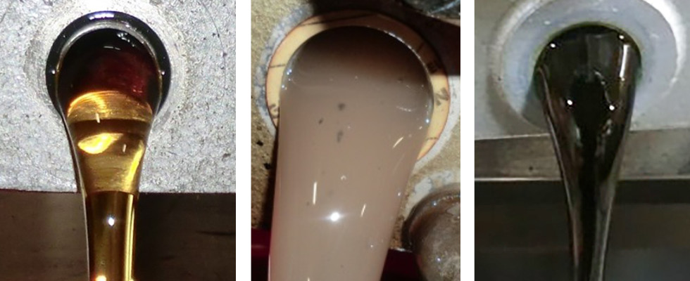

2. Inspect oil condition: Clean oil will appear clear or slightly yellow. If it has a milky or cloudy appearance, water contamination is likely. A dark or sludgy appearance indicates oxidation or chemical breakdown. Both are signs that an oil change is needed.

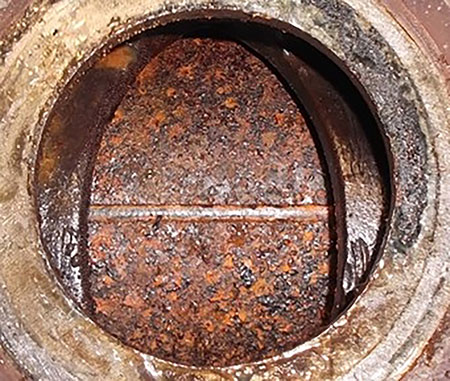

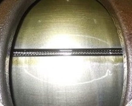

2. Inspect vanes and rotor (if accessible): While this step is not always required monthly, it is smart to periodically check the vanes for wear, especially if performance issues have been noticed. Worn vanes can stick, chatter or fail to seal, reducing vacuum efficiency.

1. Replace vanes and seals: Vanes wear down over time and lose their ability to form an airtight seal. Some pumps feature vanes that can be inspected without full disassembly, while others may require more extensive teardown. Replace vanes if they are below the minimum thickness specified in the manual or show signs of chipping or uneven wear. Replace gaskets and seals to ensure vacuum integrity, especially in pumps that have been exposed to chemicals or high heat.
