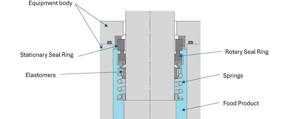

Mechanical seals used in food and beverage manufacturing frequently operate in indirect food contact conditions—interfaces exposed to condensate, aerosols, clean-in-place (CIP)/sterilization-in-place (SIP) media and transient product splashes. Despite the “indirect” designation, the expectations in major markets for migration-control, documentation and good manufacturing practice (GMP) often mirror those for direct food contact.
This article presents a decision framework for selecting elastomers, thermoplastics, hard faces, metals and adhesives for mechanical seals where materials may indirectly contact food, integrating current regulatory changes. It also translates these developments into material selection criteria, testing strategies and supplier documentation requirements applicable to pumps, mixers, valves and homogenizers, providing an audit-ready approach that reduces risk while supporting global commercialization.
Seals at pump, mixer and valve interfaces are exposed to heat, pressure, motion and chemicals that can accelerate diffusion of residual monomers, oligomers or additives. In indirect contact scenarios, condensate, aerosols or barrier fluids can act as migration vectors. Accordingly, seal stacks (elastomers, plastics, faces, metals and adhesives) should be selected and validated as food-contact materials (FCMs) to ensure any transfer to food remains safe and compliant (Image 1).
John Crane)
