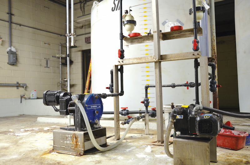

Pump SystemImage 1. The introduction of biocides or growth inhibitors can manage microorganisms. (Courtesy of Graco Inc.)

One effective approach plant managers can take to properly control the growth of disease-harboring microorganisms is to introduce a biocide or growth inhibitor into the system. Out of three types of growth inhibitors—oxidizing, non-oxidizing and bio-dispersant—the most common is an oxidizing inhibitor, such as sodium hypochlorite, also known as bleach, which can be introduced into the system in liquid form to effectively kill microorganisms and prevent further growth.
Sodium hypochlorite can be a difficult liquid to handle due to off-gassing, which occurs during pumping. Due to the introduction of gas into the fluid stream, peristaltic pumps are the preferred technology because of their lack of check-valves, allowing them to pump fluids with gas entrapped inside. Single diaphragm style pumps have issues handling gas and can become vapor locked without the installation of an off-gas valve.

Minnesota Power, a utility company based in Grand Rapids, Minnesota, has previously used single diaphragm metering pumps to transfer a mixture of 17 percent sodium hypochlorite to combat bacteria growth in its cooling tower and condenser cooling systems. The utility found that the single diaphragm metering pumps were costly to maintain and did not handle the off-gassing of bleach as well as peristaltic hose pumps. Minnesota Power added some pumps, including a new model peristaltic pump with a CSM hose and Hastelloy barbs to handle sodium hypochlorite.
Since the switch to peristaltic pumps, Minnesota Power has been pleased with their performance. Jason Vickerman, maintenance planner for Minnesota Power, said it operates efficiently for the application. “It requires very little maintenance. The hose lasts about six months before needing to be replaced,” Vickerman said.
Minnesota Power’s internal water lab can easily test for bacterial growth and adjust bleach requirements by using a supervisory control and data acquisition (SCADA) control to speed up or slow down the pump to adapt to Minnesota’s changing climate.
“We operate a rigorous inspection procedure on our systems,” Vickerman said. “Because of the reliability of the pumps, our system has not had any issues with bacterial outbreaks or large system downtime.”
