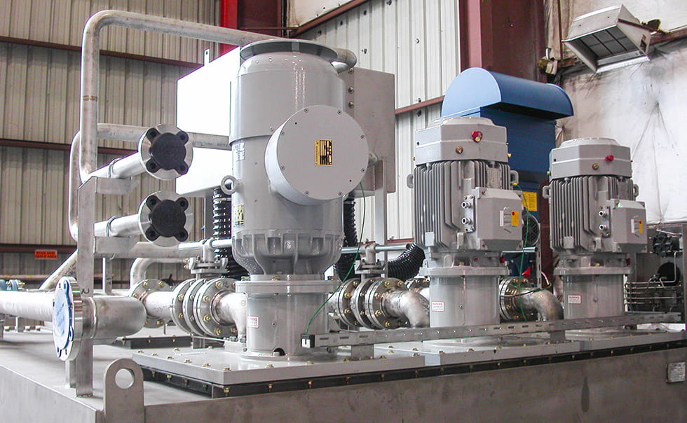

Case Study
A large OEM and manufacturer of rotating machinery had for a long time used vertical centrifugal pumps for lube oil service due to cost and simplicity. In an effort to limit oil tank size and also add more oil flow (as the machine power was uprated and more cooling was needed), the centrifugal pumps ran into difficulties with lube oil air entrainment.
Frequent trips and shutdowns caused the OEM to look at positive displacement pumps or, more precisely, three-screw pumps. However, the limitations of installation space and connections imposed on the three-screw pump made it necessary to customize the pump and also include a relief valve, which the centrifugal pump did not need.
Lube oil tank with vertical three-screw pumpsIMAGE 3: Lube oil tank with vertical three-screw pumps
Even with the confined space and installation arrangement it was possible to replace the two centrifugal alternate current (A/C) and direct current (D/C) driven lube oil pumps with three-screw pumps (Image 3).
