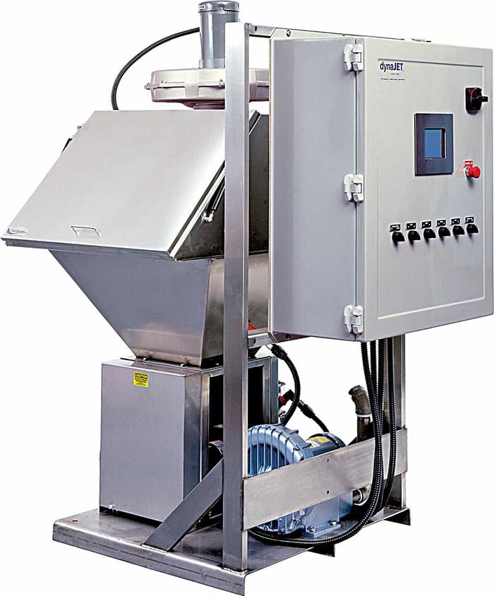

Image 1. This dry polymer preparation system was developed to be ideal for water treatment applications because it utilizes a negative-pressure, blower-induced conveyance system to transport and disperse dry polymer prior to the wetting process, which ensures effective and complete polymer-particle wetting. (Images and graphics courtesy of Fluid Dynamics)The Challenge

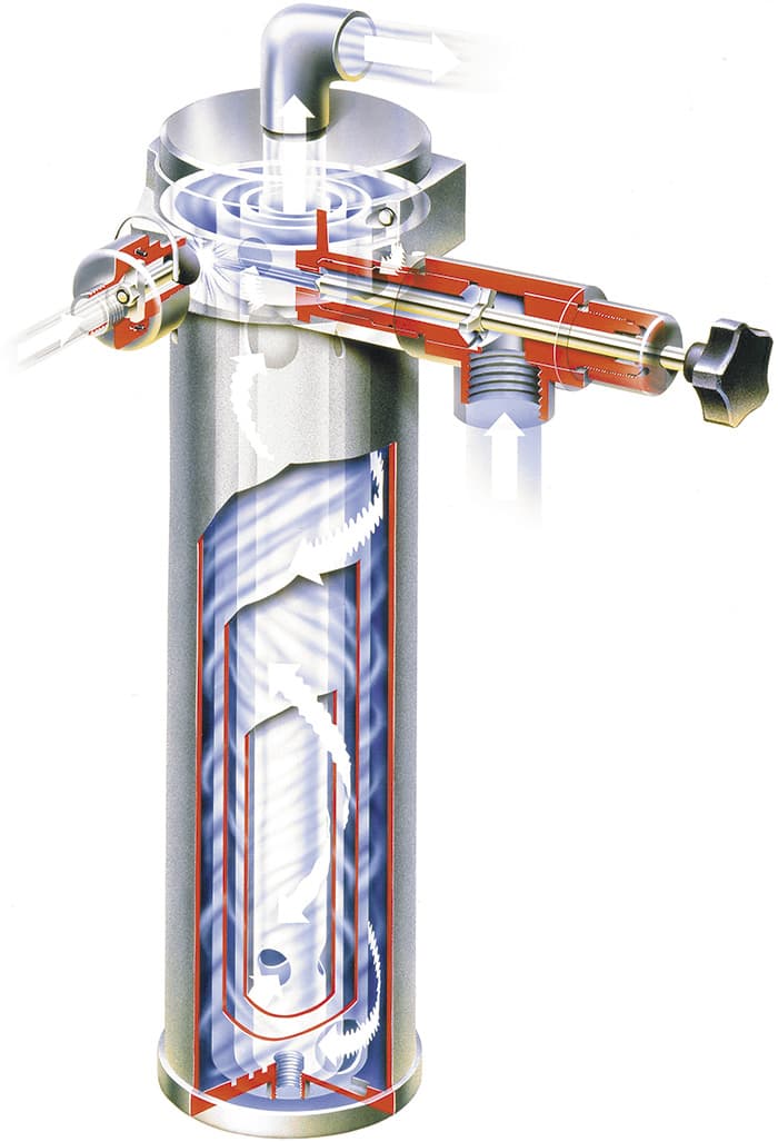

Image 2. This high-energy, non-mechanical liquid-polymer activation and blending technology activates liquid polymers, in the process rendering mechanical blenders obsolete except in low-flow applications.- Ferric chloride: Another name for iron(III) chloride, ferric chloride breaks down when dissolved in water, which gives it the ability to sufficiently form suspended solid particles into flocs.

The treatment plant operator has two polymer choices: wet or dry. In both cases, polymer preparation systems can deliver the injection rates that are required and handle the growing number of polymers that are now available, some of which are exceptionally delicate and must be handled with extreme care. Recognizing the needs in this critical area of municipal water treatment, a manufacturer of liquid and dry polymer preparation systems offers a patented liquid and dry polymer blending system. Both offer high-energy, non-mechanical liquid-polymer activation and blending technology designed to effectively activate all types of liquid polymers. The technology produces more than six times the mixing energy per unit volume than some others.
Figure 1. Patented technology produces more than six times the polymer mixing energy per unit volume than comparable mechanical polymer mixers.- Stage 1: Pressure drop across a specially designed variable-orifice water-control valve produces a high-velocity water jet, which travels at approximately 70 feet per second. The water jet is aimed directly at, and impinges on, the polymer as it enters the mixing chamber. At this point, the polymer coils up and is not susceptible to damage.
- Stage 2: In the concentric mixing chambers, the newly blended polymer recirculates multiple times for additional exposure to non-damaging turbulence, completing the blending process. The recirculation ensures that the polymer solution is present directly after the point of injection for an ideal activation and blending environment.
- Stage 3: The mixing energy then naturally diminishes in the concentric chambers, while the optimized flow path ensures optimum polymer performance by preventing the polymer from causing a disruption to the three-stage activation and blending process.
Image 3. By using a blower-induced pneumatic conveyance system to transfer the polymer from the feeder to the wetting head, the patented system is able to reduce mixing and hydration times, deliver higher polymer performance and lower chemical costs.
