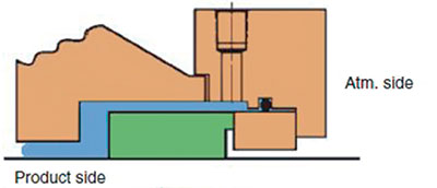

Q. What are the advantages of single, outside-mounted seals versus that of single, inside-mounted seals?
A. Single seals have one set of sealing surfaces. The lubricant for the seal faces is usually the pumped medium, and therefore, normal seal leakage will escape into the atmosphere surrounding the seal unless some type of containment is provided. Single seals can be mounted inside or outside the seal chamber and can have rotating or stationary springs.
The single, inside-mounted seal is the most common in the industry and the most energy-efficient when compared with other sealing methods, such as packing and sealless equipment. They are used in all industries with respect to fluid types and the seals’ property ranges, pressure speed, diameter and temperature.
Single, inside seals are mounted within the equipment seal chamber (see Figure 5.2). The advantages of this design include:
- The seal can be cooled by the pumped fluid in an enlarged dead-ended chamber, by a product bypass flush or by a clean external flush.
 - Depending on the seal chamber design, the rotary action of the seal assembly may help keep debris away from the seal faces.
 - With proper hydraulic balancing, the product pressure helps keep the seal faces closed.
 - Catastrophic leakage is usually avoided during seal failure. Leakage can be restricted by the stationary elements in the gland.
 - Inside seals are available in many materials and designs.
 - Environmental controls are easily included in the design.
 - Centrifugal forces tend to reduce leakage.

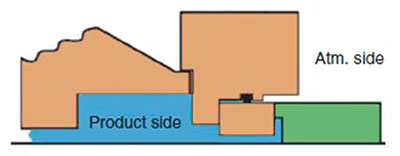

Figure 5.2. Inside-mounted, single sealSingle, outside seals are mounted external of the equipment housing (see Figure 5.3). The advantages of this design include:
- Outside-mounted seals can be used when the radial or axial space in the chamber is not adequate or access is not available for an inside seal installation.
 - Installation may be easier than with an inside seal. However, most equipment designs still require some disassembly.
 - Less expensive materials may be used since many components may not be exposed to the pumped product.
 - The seal can be observed and monitored for seal face wear.
 - Adjustments can be made without equipment disassembly.
 - The seal can often be backed-off for cleaning.
Figure 5.3. Outside-mounted, single sealFor more information about mechanical seals, see HI’s guidebook Mechanical Seals for Pumps: Application Guidelines.
