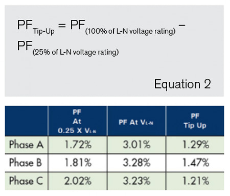

Example calculation of PF tip-up
IMAGE 2: Example calculation of PF tip-up
Power Factor Tip-Up Tests
While power factor testing applies to most types of insulation, power factor tip-up tests are primarily applicable to dry-type insulation such as is found in dry-type transformers and rotating machinery. Performing power factor testing of motor windings can serve as a baseline measurement for trending purposes over time. A power factor (dissipation factor) tip-up test is a variation of power factor testing that is widely used to identify voltage dependencies in winding insulation. Information regarding this topic is available in the Institute of Electrical and Electronics Engineers (IEEE) 286-2000, “IEEE Recommended Practice for Measurement of Power Factor Tip-Up of Electric Machinery Stator Coil Insulation.”
To better understand the value of power factor tip-up, first define what it is and how it differs from a standard power factor test. The power factor tip-up is defined as the difference between the power factors measured at two designated voltages applied to an insulation system, other conditions being constant (see IEEE 100 “Authoritative Dictionary of IEEE Standards Terms”).
In this test, the power factor is measured at two different voltages. The first test voltage is often conducted at 25% of the rated line-to-neutral voltage. This should be a low enough voltage that ionization of voids (partial discharge) within the insulation has not yet begun to occur. A second power factor test is performed at 100% of the rated line-to-neutral voltage. The tip-up value is derived by subtracting the value of power factor at the lower test voltage from that of the value of power factor at the higher test voltage.
Greater resolution to the characteristic of power factor tip-up will sometimes be attained by testing at additional voltages between 25% and 100%. For example, power factor tests may be performed at 25%, 50%, 75% and 100% of rated line to neutral voltage and then plotted to give a visual indication of an insulation’s voltage dependency (Image 2).
