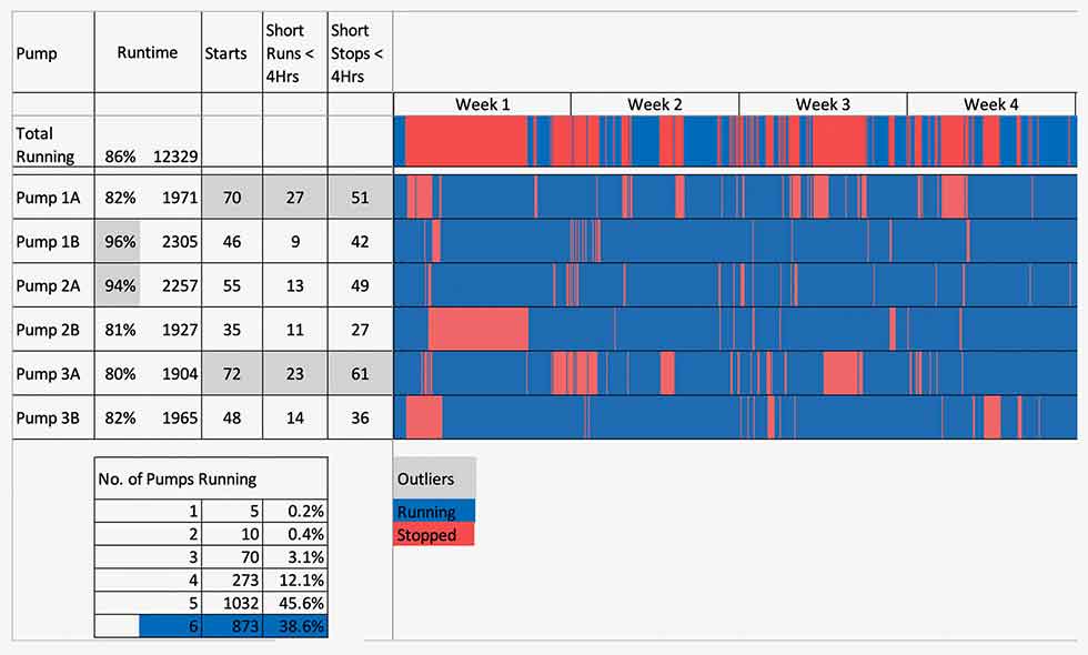

heatmap pump application
IMAGE 1: Heatmap of 1:5 pump application over a four-week period at a Midwest redundant pump application (Image courtesy of Evoqua)

A vibration monitoring trial was performed over four months to understand how this technology could support asset management efforts. During the trial, vibration data was combined with operational data to gain additional insights. Faulty valves, questionable pumps and the actual level of system redundancy, versus theoretical, was discovered. The refinery’s water demand had increased over time, resulting in the need to run redundant systems to meet peak demand requirements. Insight into actual system redundancy helps with risk management and new asset justifications.
Data science techniques for assessing the pump system as a whole were deployed for additional insight. Two points were established using data science:
  • Detecting an impaired redundant pump system that runs in simplex 38.6 percent of the time
  • Detecting pump interaction on a common header due to incorrectvalve position

Multiple industry studies agree that a common cause of failure for redundant pump applications is improper operation or maintenance. The data in the heatmap (Image 1) is of a 1:5 redundant pump application and shows the backup, or sixth pump, is actually running as primary mover for 38.6 percent of the time (blue in Row 1). This means the pump system is running in a simplex and not redundant mode for 38.6 percent of the time. The drill down information for the operation of each of the six pumps is shown in Rows 2 to 7. The short red slices indicate the pump cycled off for a very short time period and then restarted. Due to insight from the visualization, the control scheme is being evaluated for starting and stopping the pumps. At the bottom of the report is a table histogram of the number of pumps in service.
