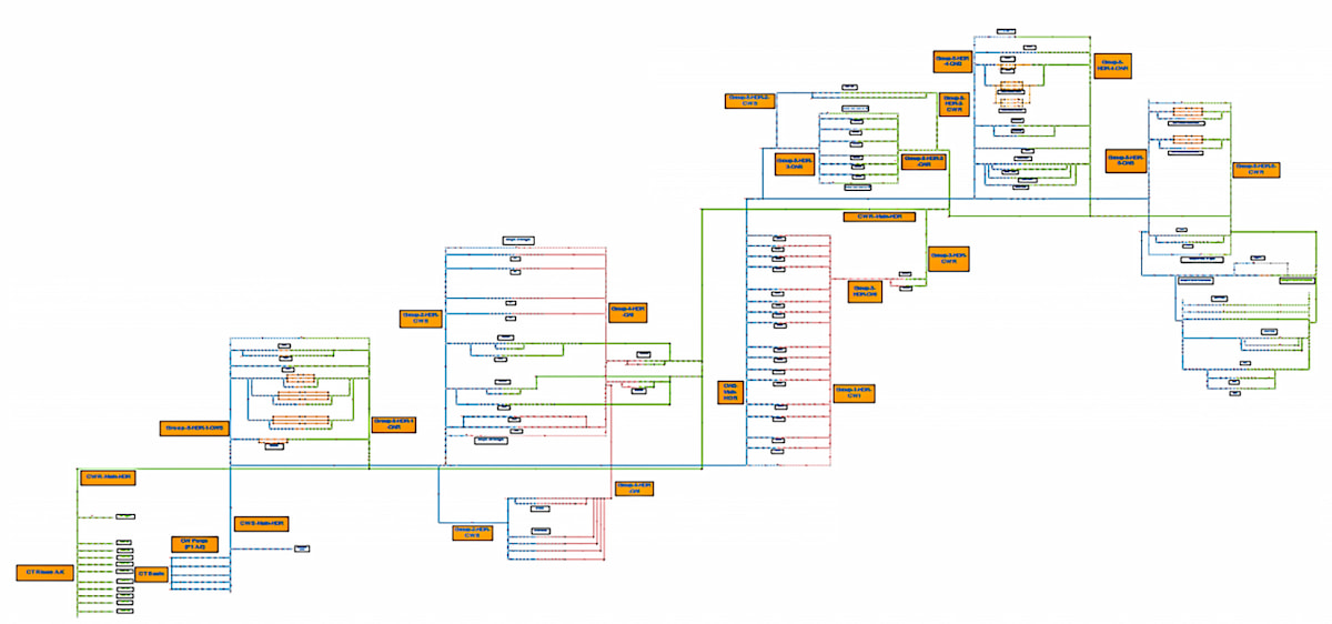

IMAGE 1: Simplified layout of petrochemical cooling water system created in hydraulic modeling software. Color-coding is used to represent the supply lines (blue), intermediate lines (orange) and return lines (green). (Images courtesy of AFT)

Example Pump System No. 1
In this study of a petrochemical cooling water system, engineers were asked to address capacity shortages in an existing system. A sensitivity analysis was performed to determine what changes would be most effective, including valve settings, component replacement and several pump operational changes. Engineers recommended updating the components in one area to reduce the flow, which allowed the user to run fewer pumps in parallel and still meet the desired capacity. Overall, the user increased capacity and decreased maintenance costs, which would not have been possible if only the pumps had been analyzed. Image 1 shows a simplified overview of the system.
Takeaway point: Do not underestimate minor system components
The layout of the piping and equipment will most likely be dictated by the process and size restraints of the site. However, some flexibility may be available in the pipe sizes and minor fittings used in the lines.
Sizing pipes, minor fittings and the pump(s) used for the process should be done in tandem. There will not be one singular combination of equipment that can deliver the desired flow, head, etc. However, there will be some combination of equipment that will minimize cost while still meeting demand. It is tempting to save time by just selecting line sizes based on previous existing designs, then choosing the cheapest pump that will meet the user’s demands. However, it is unlikely that the previous designs were optimized, and thus, this method just perpetuates mediocre design choices made for convenience.
With the pipe flow modeling tools available in the market today, it is relatively easy to analyze many pipe size/pump size combinations in a short amount of time rather than relying on previous projects to make expensive equipment purchases. This could result in capital savings up front and savings on operating costs in the long term.
When working on updating an existing system, there will still be opportunities to improve the system. Remember, performance is driven both by the pump and piping configurations; therefore, changes should be considered to all components, not just to the pump. Any method to reduce system resistance can help increase pump output overall.

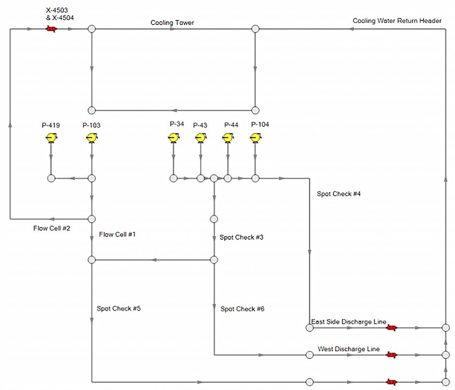

Example Pump System No. 2
In a separate study involving a cooling water system for a refinery, engineers determined the cause of excessive erosion in the suction side of the pumps.
After collecting data and creating a hydraulic flow model, the engineer determined the pumps were operating on the low end of the preferred operating region (POR), as defined by the American National Standards Institute/American Petroleum Institute (ANSI/API) standard 610 11th edition, which specifies the POR is 70% to 120% of best efficiency point (BEP). Most of the pumps appeared to be operating at about 73% on average based on the flow model.
Takeaway point: Do not ignore BEP
When choosing a new pump or evaluating the operation of an existing pump, it is important to operate as close to the BEP as possible. Operating near BEP reduces operating costs and decreases wear to the pump caused by heat and vibrations as the pump operates away from BEP.
To minimize damage, it is recommended to run the pump in the POR specified by the manufacturer or as is defined in the ANSI/API standard 610 11th edition. Several methods can help keep the pump operating within the POR. If the pump is operating far from BEP, the most efficient solution would be to run the pump at a lower speed to operate the pump as close to its BEP as possible. Using a variable frequency drive (VFD) can help control this speed change, especially during unsteady operation where the operating point will be shifting.
Impeller trimming would also be relatively efficient as it would lower the power consumption for the pump. However, impeller trimming allows much less flexibility for changes to be made later in the pump’s life cycle.
The worst solution power-wise would be to use a throttling valve. While the capital expenses for a valve are typically lower than a VFD, throttling the pump will require the full power consumption of the pump, which will be used to overcome the extra resistance at the added valve.
