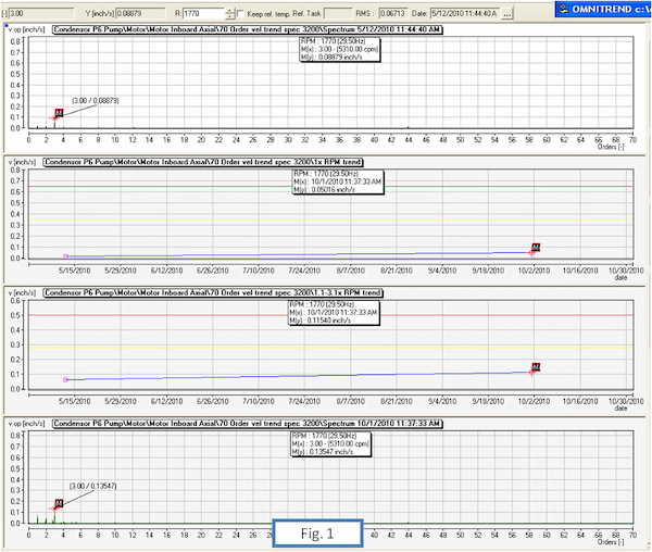

Figure 1 shows a fast Fourier transformation (FFT) analysis taken in May 2010 (the scale is high to accommodate and compare peaks in subsequent measurements), along with a trend of the band of energy around 1 times (×) turning speed, a trend of the band encompassing 2 and 3 × turning speed and another FFT taken in September 2010. Figure 1 is in the axial orientation.
FFT analysis in May 2010 and September 2010
Figure 1. FFT analysis on May 2010 and September 2010
The energy content around 1× turning speed more than triples, while the energy around 2× and 3× turning speed more than doubles from May to September. Notice from the spectrum that 3× is the dominant peak. A trend with only two points of data can hardly be called a trend. In fact, no functional validity could be attributed to the trend at this point. A percent-of-increase alarm was tripped (not shown). Therefore, an investigation would be ordered.
Study of this axial FFT revealed that 3× turning speed is the dominant peak and 2× turning speed is also prominent. This hinted that something was less than optimal on this pump train. In fact, the dominating 3× component indicated, with a high probability, stress on the coupling that had three contact points in the interface.

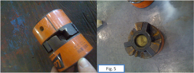

When taken offline for repairs, the repair provider discovered the true damage. The coupling had been destroyed (see Figure 5). The part of the rubber spider (insert) that drove the pump in the direction of rotation was completely gone. In fact, it was apparent that it had been gone for some time. This had allowed the metal jaws of each coupling half to contact one another, and during the months, a large amount of metal had been removed from each of the three jaws on each half of the coupling.
The pump train was in misalignment, just as the analyst had predicted, only now the misalignment had destroyed the coupling, as well. The number of years that have possibly been removed from the life of the bearings can only be speculated, but it is a certainty that 300,000 impacts per hour for about 14 hours per day for more than a year significantly affected the bearings’ lifetime.
The destroyed coupling
Figure 5. The destroyed coupling
