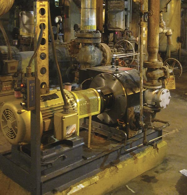

A refinery in Northwest Indiana is home to an internal power plant, which includes three high-pressure service water pumps. These pumps provide cooling water to the bearings for the forced-draft fans on top of the boiler house. They also cool two other pieces of equipment throughout the power plant. The pumps are 1947 vintage Ingersoll-Rand, 3BEV, two-stage horizontally split pumps (see Image 1). Packing is used for sealing instead of mechanical seals. In addition, the pumps use greased bearings and are designed to provide a flow of 500 gallons per minute (gpm) at 250 feet of total dynamic head (TDH). The pumps have been reliable with low vibrations. The main maintenance tasks are monitoring and replacing the packing and changing the bearings in the field.
After many years in service, the pumps began to degrade internally and stopped meeting the designed service requirements. Considering the critical nature of these pumps, the power plant unit determined that returning them to the designed performance levels was imperative. The unit's maintenance and engineering team developed a set of options and scheduled maintenance at the next available opportunity.
Considering the high cost of repairs (because of the pumps' size) and the fact that the existing pumps had a cast-iron body, opportunities for upgrades were scarce. Knowing that the pumps had not been repaired in more than 20 years, the team anticipated an extensive scope with significant costly internal and external weld repair (see Images 2 and 3). The team had a choice: They could either spend a significant amount of money on repairs to an obsolete pump or seek alternatives.
