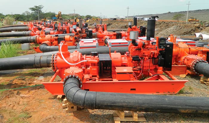

Image 1. Pumps are used to move 122 million gallons of water per day to fill the third set of locks for the Panama Canal project.Image 1. Pumps are used to move 122 million gallons of water per day to fill the third set of locks for the Panama Canal project. (Images courtesy of Xylem)

To meet the tight time challenge, five Boeing 747 cargo planes transported the rental pumps and equipment from the U.S. to Panama. Fifteen automatic self-priming pump systems and 2.8 miles of high-density polyethylene (HDPE) pipe were deployed from the U.S. in June. Over a period of 22 days, these pumps transported up to 122 million gallons of water per day. The project pumped enough water to fill 90,000 average-size swimming pools.
The self-priming pump systems that were used in the project offer flow rates up to 9,770 gallons per minute (gpm) and can handle solids up to 4.9 inches in diameter. The pumps can automatically prime to 28 feet of suction lift. Solids-handling capacity, dry-run capability and portability make these pumps ideal for high-volume dewatering, as was required for the Panama Canal project. Each of the pumps was equipped with an 18-inch pipe and a flow meter, ensuring that the required volume of water was pumped within the time frame.
