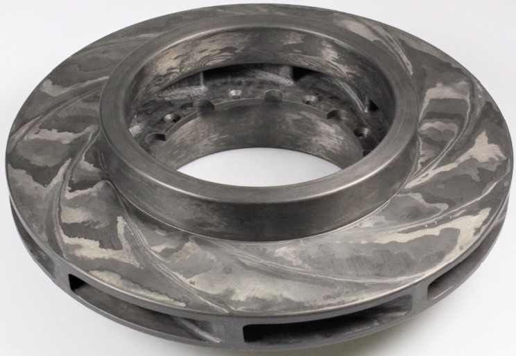

The transition to low-carbon energy demands rotating equipment capable of handling extremes, pressures, temperatures and media that were not anticipated by legacy specifications. Hydrogen is one such case. Compressing hydrogen gas using centrifugal methods requires impellers that spin far beyond the safe limits of metals. Traditional alloys fail at around 450 meters per second tip speed. Hydrogen, due to its low molecular mass, demands over 600. That gap defines the difference between what is feasible and what is impossible.
Composite impellers, made from engineered thermoplastic materials with embedded carbon fibers, are now proving they can close this gap. After years of development, recent tests have demonstrated tip speeds of 688 meters per second, surpassing the threshold needed for efficient hydrogen compression and opening the door to centrifugal compressors as viable tools for fueling the hydrogen economy. This advancement is not limited to hydrogen. For other gases, higher speeds mean fewer compression stages, lower capital costs and smaller equipment footprints.
Unlike traditional reciprocating compressors, which are expensive to maintain and operate, centrifugal designs are more scalable and energy-efficient, provided the materials used can withstand the stresses. In hydrogen infrastructure projects, such as Europe’s planned 40,000-kilometer hydrogen backbone, centrifugal compressors equipped with high-speed composite impellers could eliminate the need for dozens of small-scale reciprocating units. Each recompression station along this pipeline must operate efficiently and safely, compressing hydrogen to pressures of 250 bar or more. Composite impellers make this technically and economically viable.
These gains are underpinned by the intrinsic properties of thermoplastic composites. Their high strength-to-weight ratio allows for higher rotational speeds, while their resistance to chemical attack and thermal shock enables use in harsh or cryogenic environments. Low electrical conductivity eliminates eddy current heating, a persistent problem in magnetically driven pumps. Replacing metallic pump shrouds with composite shells, for instance, not only improves efficiency by reducing magnetic losses but also ensures thermal stability in dry-run scenarios that could damage the pump.
