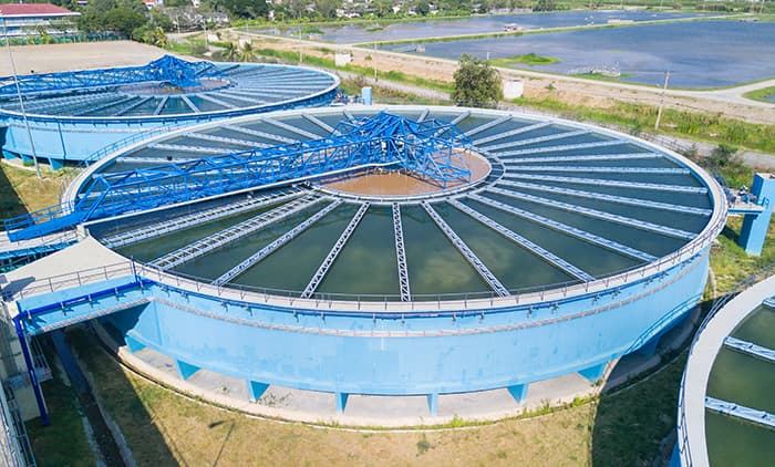

Organic contaminants in water serve as nutrients or shelters for microorganisms. Water disinfection removes or deactivates these contaminants. Water contamination typically comes from human activities. Human waste or pharmaceutical pollutants make their way into water sources through sewers. Industrial process water used by manufacturing, chemical plants, the energy industry and other applications gets discharged back into rivers and streams. Agriculture fosters natural nutrient enhancement, which increases the volume of nitrates and phosphates in water and encourages algae growth. All of these activities bring an array of bacteria, acids, salts, toxic metals, nitrates and suspended sediment into the water supply. Steps to treat water (on both a municipal and industrial level) include screening debris, odor control, filtering sedimentation, pH control, coagulation and flocculation, disinfection and other steps including fluoridation. This article focuses on disinfection, which is primarily accomplished using chemicals such as sodium hypochlorite. It identifies the strengths and weaknesses of the disinfectant, and it highlights some of the challenges that pumping equipment must address to effectively handle sodium hypochlorite.
