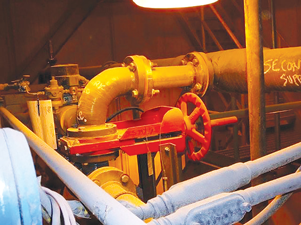

Push-through knife gatesWhile push-through knife gates are not ideal for the lime slurry in emission scrubbers, they can fit into tight spaces compared with other valves.

A knife gate is also not ideal for handling lime slurry. The abrasive slurry will require a specially designed knife gate that incorporates a push-through gate and rubber sleeves. When the valve is 100 percent open, the rubber sleeves are the only components in contact with the lime slurry.
Knife gateKnife gates can handle scrubber lime slurry only after specialized modifications—otherwise, abrasion wears the valve and leakage can occur.
The two rubber sleeves form a seal that prevents leakage out of the valve and isolates the stainless-steel gate. When the gate closes, it separates the rubber sleeves and pushes any buildup or scale out of the bottom of the valve and into a flushing area. Without regular flushing with clean water, lime deposits will pack the flushing area and damage the valve. The stainless-steel gate may need to be coated with PTFE. The coating allows lime scale to be wiped clean by secondary seals on opening and closing. When choosing between the PTFE coating or stainless steel, operators should remember the hassle of protecting the knife gate from scaling.

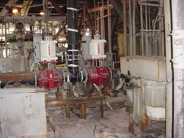

Pinch valvesPinch valves are the best valve choice for handling abrasive lime slurry, but they also serve an important role controlling coal ash in power plants.
When selecting a pinch valve, higher quality means better performance. Inferior rubber manufacturing methods can severely limit the self-cleaning features that make pinch valves a top choice for emissions scrubbers. Consumers should choose brands that have proper quality control and International Organization for Standardization (ISO) 9001 certification. Grades of stainless steel vary little between manufacturers, but natural rubber or styrene butadiene can vary greatly in its quality and performance characteristics.

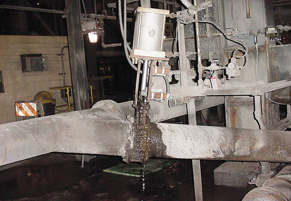

Pinch valvesBottom ash systems combine coal ash with high-pressure water, which can damage valves. Pinch valves offer a cost-effective solution.

Lime or lime slurry is not limited to the power industry. The substance, which can also be used to control pH, has applications in the steel manufacturing, food and beverage processing, glass, pulp and paper, chemical and mining industries. All these industries, along with the power generation industry, share a need for an effective valve solution to handle lime slurry. Coal-burning power plants can use special rubber-lined, push-through knife gates and pinch valves in their bottom ash systems. Burning coal produces spent ash that, when mixed with high-pressure water (for example, 25 bar), can be highly abrasive and damage valves. Push-through knife and pinch valves provide a low cost-of-ownership solution to managing coal ash and waste.
