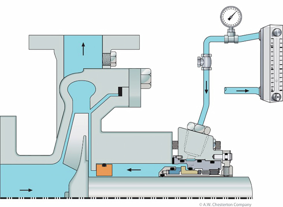

Image 1 illustrates a typical operating plan for a single mechanical seal installed in a centrifugal pump with fluids containing solids or fibrous particles. The presence of the restriction bushing is not always recommended in fibrous fluids, and in some pump designs the seal chamber diameter can be large and tapered, preventing the use of a restriction bushing. To reduce product dilution and reduce the energy consumed in the evaporation process, some users have migrated from single mechanical seals to double mechanical seals. The need for water to cool and clean the sealing device remains; however, in a double mechanical seal, little water enters the process stream. The volume would be measured in fluid ounces/day as opposed to gpm. The seal’s water flush is often piped to the inlet port of the seal, while the outlet port of the seal is piped to run to drain. In doing so, the volume of water consumed per equipment remains similar for pump packing or a single mechanical seal. Common practices are to employ valves on the drain side of the pipework to provide restriction in flow and pressure to the inboard and outboard seal faces.
Mechanically sealed pump with static shaft sleeve/sealing surface
IMAGE 1: Mechanically sealed pump with static shaft sleeve/sealing surface
