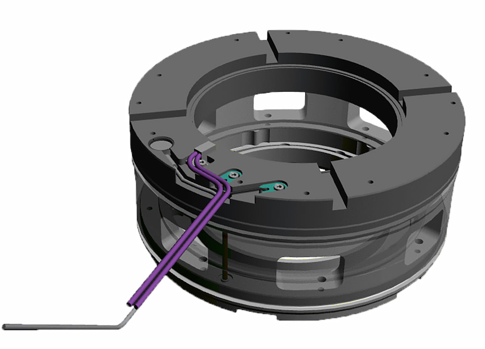

IMAGE 1: Sensor data from smart seals can be combined, processed and uploaded to process control and distributed control systems and sent to cloud servers. (Image courtesy of John Crane)

Digital diagnostic technology that provides real-time information on the seal’s health is now available. Sensor data from smart seals can now be combined, processed and uploaded to process control and distributed control systems and sent to cloud servers.

An engineered technology provider worked with the technical authority for rotating equipment at the facility to extend the compressor mean time between repair (MTBR) and improve the visibility into the dry gas seal’s health. The team installed two smart seals on both the drive and nondrive ends of the compressor.
Leveraging machine learning, the system allowed the operators to assess the health of the compressor’s dry gas seals installed in the turbomachinery and optimize the reliability and performance of the rotating equipment. By understanding the remaining useful life of the mechanical seals, the LNG plant could add months, if not years, to the time before the equipment’s next repair, reducing maintenance costs.
The system included sensors embedded in the dry gas seals, enabling health monitoring. In the event of a high alarm on transmitters (i.e., high leakage flow or vibration), the LNG company could proactively shut down the compressor before further damage occurred and potentially unmask a true root cause of
the problem.
The smart seal’s sensors collect data on conditions that impact seal health using a highly secure, four-step data flow process. The encrypted data from the various sensors is combined, processed and uploaded to the existing control systems and sent to the cloud for real-time processing and archiving. Real-time preset alerts and alarms are also sent to applicable devices.
