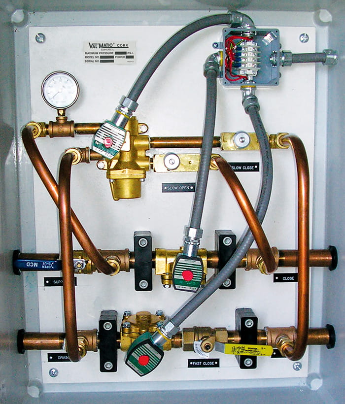

The ball valve performs the critical function of an automatic check valve, so it needs to be reliable and tight-closing. The ball valve is powered by an oil-powered cylinder actuator built in accordance to AWWA C541, which requires specific materials of construction and production test to ensure a high level of quality and dependability. The barrel of the cylinder is constructed of a lined fiberglass tube to prevent corrosion. The cylinder rod is hard chrome plated stainless steel to prevent wear and corrosion in the cylinder. The hydraulic cylinder is coupled to a quarter-turn, link-lever actuator to provide the required 90-degree rotation to operate the ball valve. Mounted on the actuator’s top is a limit switch control unit that provides a remote signal for valve full-open and full-closed positions. The entire valve assembly was built and tested together in the factory in accordance with AWWA C507. The valve’s hydraulic actuator is controlled by an oil-hydraulic control system consisting of a four-way solenoid valve that opens the ball valve when energized (see Image 2)..jpg)
Smart Electrical Panel
A smart electrical control panel is mounted on top of the hydraulic panel and provides the interface between the hydraulic system and the pump’s drive control unit. The electrical panel displays pump system operation, valve position and alarm indications. The sequence of operation is similar to any check valve, but there is a unique aspect. When a pump is started, its pressure is sensed by a pressure switch, which sends electrical power to the four-way solenoid valve, opening the ball valve. When the “stop” signal is given, the four-way is de-energized, closing the ball valve. However, while the ball valve is closing, the pump continues to run until the ball valve is fully closed, then a limit switch on the valve trips off the pump. In general the ball valve operates like a check valve, but it does so in slow motion and with no slam. The electrical panel has three independent safety modes to monitor the pumping system. Upon receipt of a pump “start” signal, the pump discharge is monitored by an adjustable pressure switch mounted on the pipe’s discharge. If the pump does not reach normal operating pressure of 110 psig within an adjustable time period of 1 to 10 minutes, a safety circuit will close the ball valve and provide an “emergency stop” signal, locking out the system until it is reset. There is a second safety mode that similarly shuts down the system if the pump runs at a high pressure exceeding 140 psig for an extended period, which may be a result of a downstream closed valve. Finally, if the pump discharge pressure drops below 95 psig for an extended time, a similar safety mode is triggered. The smart panel is wired to the pump control drive for remote monitoring of conditions and helps protect the pumping system from abnormal operating conditions.Conclusion
