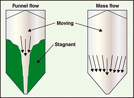

Diagram of rat-holing/funnel flow (Images courtesy of Trillium Flow Technologies)
IMAGE 1: Diagram of rat-holing/funnel flow (Images courtesy of Trillium Flow Technologies)

  • Sludge consistency changes are a major influence on pump selection. Concentrations of raw, digested or digesting solutions of up to 8% solids can be handled by centrifugal pumps, provided their net positive suction head (NPSH) requirement is not exceeded, and their speed can be varied to accommodate changing sludge consistencies. Another problem to watch for is “rat-holing” or funnel flow in the sludge. Above 8%, positive displacement lobe pumps are recommended as standbys, and above 10%, they should be used exclusively.

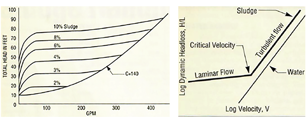

Left image: Typical system head curve, Right image: Typical sludge and water flow curves
IMAGE 2 (left): Typical system head curve
IMAGE 3 (right): Typical sludge and water flow curves

Most users agree that calculating total dynamic head is the greatest challenge they face in heavy sludge media. Image 1 shows a typical system head curve of a 4-inch diameter sludge line with a 10-foot positive suction head, 10-inch static lift and piping length equivalent to 1,000 linear feet at various consistencies.
Wastewater sludges behave as non-Newtonian fluids for which frictional or dynamic head loss is a function of the flow properties of the sludge, the pipe diameter and the flow velocity. Dynamic head losses between five and 20 times those expected for water are common for sludge flowing through pipelines. Below the lower critical velocity, flow is laminar. Above the upper critical velocity, the flow is turbulent, and the material acts as a Newtonian fluid (Image 2). Head loss for turbulent sludge flow is much more sensitive to changes in velocity. For non-Newtonian fluids, techniques are available to predict head loss in both laminar and turbulent flow.

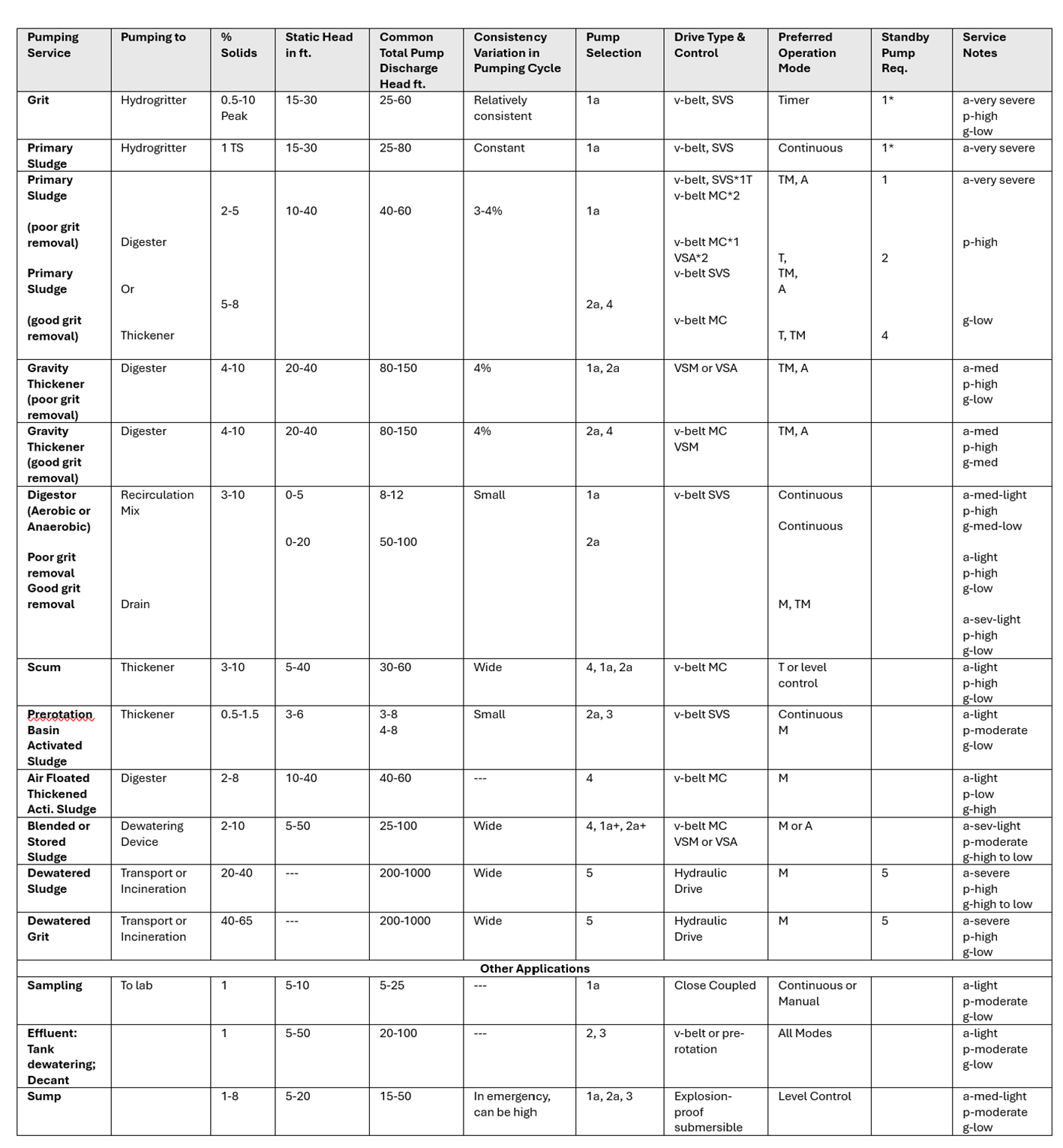

IMAGE 4: Sludge services application chart

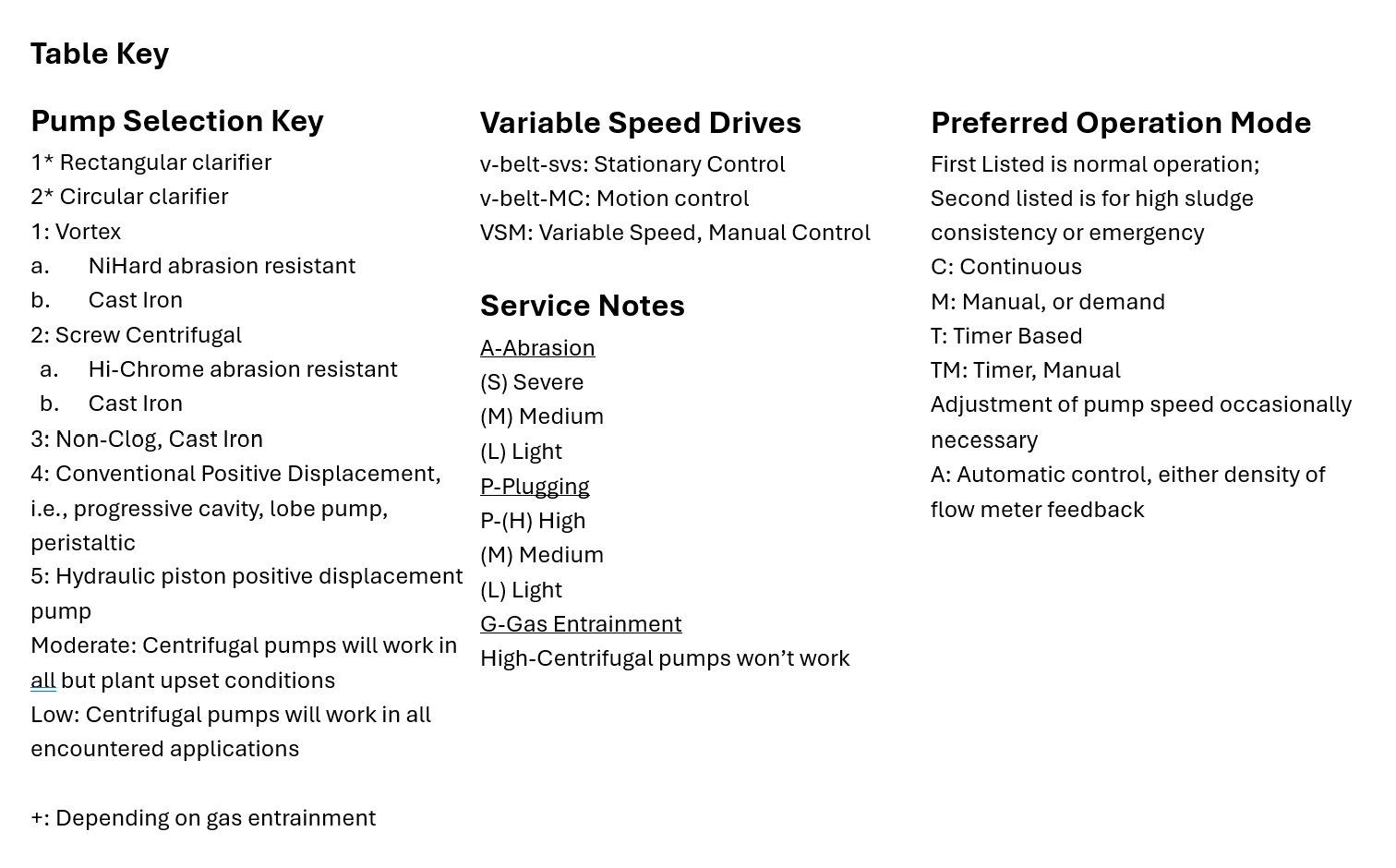

Table Key
Suction Side Critical
All this implies that a great deal of attention should be paid to the suction side of the pump when working with sludges. Here are a few important guidelines:
  • Ensure adequate NPSH is available from the system, no matter which pump is selected.
  • Suction piping should be kept as short and straight as possible.
  • Sludge velocities should be kept above 4-5 feet per second (ft/sec) to avoid sedimentation in the line and to reduce grease buildup.
  • Derivation and analysis of the system head curve should be thorough.
  • A range of expected losses at a given consistency should always be evaluated—that is, normal and worst case at a specific concentration of solids. A range of concentrations should be evaluated, since the concentration will be heaviest at the beginning of the pumping cycle and lighter toward the end of the cycle.
  • No matter what pump is selected, positive displacement or centrifugal, a variable speed device should be available. These can range from simple, adjustable V-belts to a variable frequency drive (VFD).
