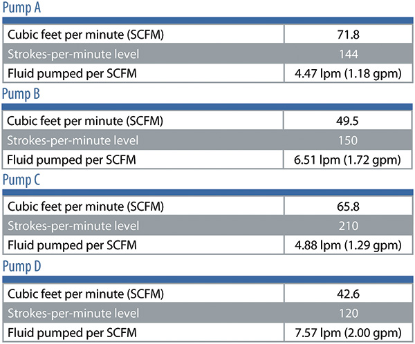

To create real-world conditions to measure the effectiveness of different ADS technologies industry-wide, a controlled, objective head-to-head test was arranged comparing several AODD pumps that were fitted with traditional, electronically controlled and mechanically actuated ADSs. Common conditions of service that are seen in the field were replicated in the laboratory. This simulated application required each pump to produce a flow of 320 liters per minute (lpm)—85 gallons per minute (gpm)—against a head pressure of 2.1 bar (30 psi). To achieve a fair comparison between these competing pumps, each pump was run at the inlet air pressure needed to meet the common condition of service. Air-consumption data was then recorded (see Table 1 for the results for four pumps).
Table 1. In a controlled head-to-head laboratory test comparing eight AODD pumps operating under common parameters seen in the field, this sample of four illustrates Pump D’s standout results and the wide range of energy and strokes required to achieve similar fluid output.The Solution
The data gathered in the objective AODD testing show that Pump D—which used the ADS that restricts air flow into the filling air chamber to minimize wasted compressed air—had better performance in all three points of measurement. It had the lowest air consumption in standard cubic feet per minute (SCFM), the lowest strokes per minute and the highest volume of fluid pumped per SCFM. Pump D averages an overall 30 percent reduction in air consumption compared with Pumps A, B and C. It also provides the largest reduction in air consumption among the four pumps while still managing the best overall volume of fluid moved per stroke, requiring the fewest strokes per minute. The air-restricting ADS in Pump D is a new way to look at how pneumatic pumps operate. To combat overfilling, the ADS used in Pump D restricts the air flow into the filling air chamber at the end of the pump’s stroke, which minimizes the compressed air that is wasted. The air control spool of this ADS meters the air to prevent overfilling without reducing product yield.
