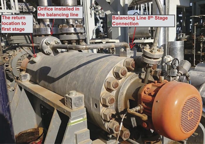

Pump arrangement installed at site showing the return line location to the first stageImage 1. Pump arrangement installed at site showing the return line location to the first stage
The balancing thrust bushing is found after the eighth B2B stage. A line is routed from the bushing's other side back to the suction. The size of the bushing must allow as much net thrust as residual thrust forces. Note that the area multiplied by the pressure difference between the suction and eighth stage discharge equals residual force.
The balancing line can be routed to two conventional locations for balancing with lower pressure side: the suction drum or the pump suction nozzle. The balancing line is at the suction pressure, where it receives the liquid condensate that increased in temperature through pumping for eight stages. This combination of temperature gain and exposure to low pressure can cause the high vapor pressure condensate to flash. Mechanical seals may also cause problems, including:

One condensate pump OEM offers BB5 pumps with a design option to route the discharge of the first stage. Image 1 shows the pump arrangement installation.
This means the balance leakage at the bushing will move from eighth-stage pressure to first-stage pressure (which varies in the presented cases from 3.6 to 7.4 bars) instead of suction. At the same thermal energy level introduced to the liquid condensate, the possibility of condensate flashing to vapor at high pressure (in the first stage) decreases. So the MCTF (shown in Table 2) is lower with a wider pump operation range. These examples show that the more pressure exists at the balancing line exit, the less flow is required to overcome the heating (the less MCTF). Any flow recycle is an energy waste and will decrease the process efficiency.

Because of the flashing nature of condensate, the thrust balancing line may also affect the MCTF of the pump. The pump OEM and contractor performed extensive analysis to understand factors affecting the MCTF. This analysis revealed that the balancing line conventional return locations may not achieve the required values of MCTF, so further enhancement is needed. One example is the installation of orifices, which showed significant improvement in the MCTF values.
In severe cases where orifices cannot provide an adequate solution to the MCTF issue, balancing line is then routed to the higher pressure side (first-stage impeller), which leads to a wide separation between the vapor pressure at the balancing line inlet temperature and the line pressure. This causes a significantly lower MCTF to match the operation need.
