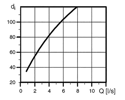

Relationship between inner diameter of the discharge pipe (di) and the flow (Q)The figure shows the relationship between inner diameter of the discharge pipe (di) and the flow (Q), according to EN 12050-1. The curve shows a velocity of 0.7 m/s.
The number of pumps to be considered can be calculated using the Poisson distribution. As a general rule, roughly 3/4/5 pumps can run simultaneously in a system of 30/60/90 installed pumps with a probability of less than 2 percent.
