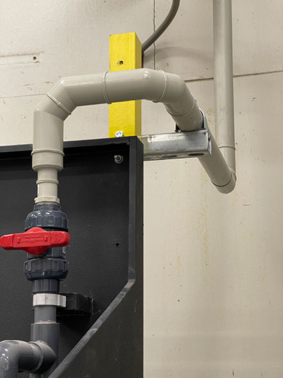

1. Improper Pipe Support
Unsupported piping transmits mechanical stresses to the valve due to pipe weight, vibration or thermal expansion. This stress can result in cracks, leaks or complete valve failure. It is especially critical for quarter-turn valves, where closing the valve may transfer stress to the piping.
IMAGE 1: Double contained piping system and ball valve installed with proper pipe supports at a wastewater treatment plant (Images courtesy of Asahi/America, Inc.)
Avoidance Tips:
  • Install pipe supports at or near valves. Where possible, attach the valve to a support structure using integrated mounts or supplemental brackets to isolate forces and reduce stress on the valve body.
  • Accommodate thermal expansion. Use pipe loops or flexible joints to prevent expansion forces from acting directly on the valve.
  • Use appropriate clamps. When utilizing pipe supports such as U-bolts, ensure they are not overtightened. Follow local laws and recommendations, which may ban the use of U-bolts or metal clamps that do not have a nonmetallic barrier.

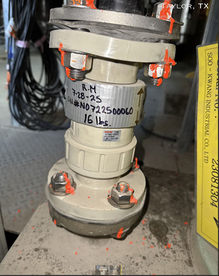

2. Not Retightening Bolts or Union Connections
Valves of any material might relax or settle during storage and installation. Without retightening before startup, leaks or failures may occur. Temperature fluctuations or pressure cycling after commissioning may further loosen these connections if left unmaintained.
IMAGE 2: If the valve is over-torqued, the quality of the product and its operational life could decrease. Defects such as warping could occur, such as the one demonstrated on this flanged ball valve. It is important to follow the manufacturer’s operation manual for the specified torque of each valve.
Avoidance Tips:
  • Retighten bolts before system startup.
  • Use a torque wrench according to manufacturer specifications. Overtightening can be just as damaging as undertightening. Tighten bolts and nuts gradually using a torque wrench, following a diagonal (cross) pattern.
  • Double-check union connections after cycling or hydrostatic testing, especially in high-frequency systems.
  • Include connection points in your startup inspection checklist.

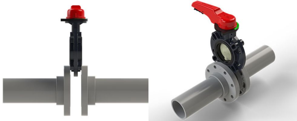

3. Poor Alignment Between Pipe & Valve
Even slight misalignment between piping and the valve can introduce shear stress that distorts valve internals, warps bodies or damages seals, particularly in thermoplastics like polyvinyl chloride (PVC) or chlorinated polyvinyl chloride (CPVC). Axial misalignment and lack of parallelism between the valve and piping can create undue stress on the valve body and seals, leading to premature failure and leakage. Proper alignment ensures reliable performance, maintains seal integrity and extends the service life of the installation.
IMAGE 3: When inserting a valve between flanges, it is important to insert after extending the fields of flanges fully. If a valve is inserted by force without fully extending fields of flanges, a liner may be turned over and suffer a crack.
Avoidance Tips:
  • Pre-align piping before final tightening. Use shims or adjustable hangers as necessary.
  • Never “pull” pipe into position using valve bolts—this introduces stress.
  • Ensure neutral pipe stress. The piping should rest naturally in alignment without tension.
  • Perform a mock-up or dry-fit before final welding or joining.
  • Clean sealing surfaces like flanges prior to joining to remove any debris.

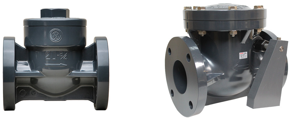

IMAGES 4-5: (Left) Flow control arrow molded on the body of a swing check valve; (right) Swing check valve with spring assist
IMAGES 4-5: (left) Flow control arrow molded on the body of a swing check valve; (right) swing check valve with spring assist
Avoidance Tips:
  • Check for flow arrows molded or printed on the valve body.
  • Install vertical check valves with adequate backpressure or spring-assist mechanisms.
  • Consult manufacturer instructions for specific orientation requirements.
