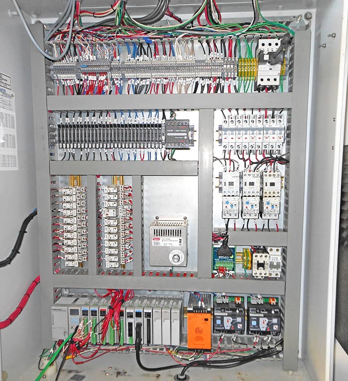

Image 2. A PLC, mounted at the bottom of the panel, provides scalable hardware and software for monitoring and control of the wastewater treatment process.Equipment Process Steps

Not only can the process be scaled, the control system can as well (see Image 2). The control enclosure, housing the programmable logic controller (PLC) and human machine interface (HMI) can handle a much larger process. Increasing the size and duplicating some of the power distribution components, motor and drives could enable pumping and treating millions of gallons of effluent per day. The process is automated with the PLC for motor control, opening and closing valves, operating pumps, and metering biochar and ozone. The PLC also monitors flow and level for process signal control and sampling operations. The process treatment sample sensors included pH, redox, dissolved ozone, head-loss, turbidity and total organic carbon. The process control hardware also provides supervisory control and data acquisition for the process trailer, and includes wireless streaming capability. The controller technology offers a modular, rack-based system with extensive discrete, analog and specialty I/O module options. The high-performance CPU has the memory, I/O capacity, communication ports and scan times needed for the current process, and for a larger scaled-up process.Data Logging
Data logging is a vital part of this process and the related research activities. Significant amounts of data are logged using the controller and the HMI. The controller provides up to 32 GB of data storage using a standard microSD card. Users access the controller’s built-in web server using any browser to view, download or delete data log files.
