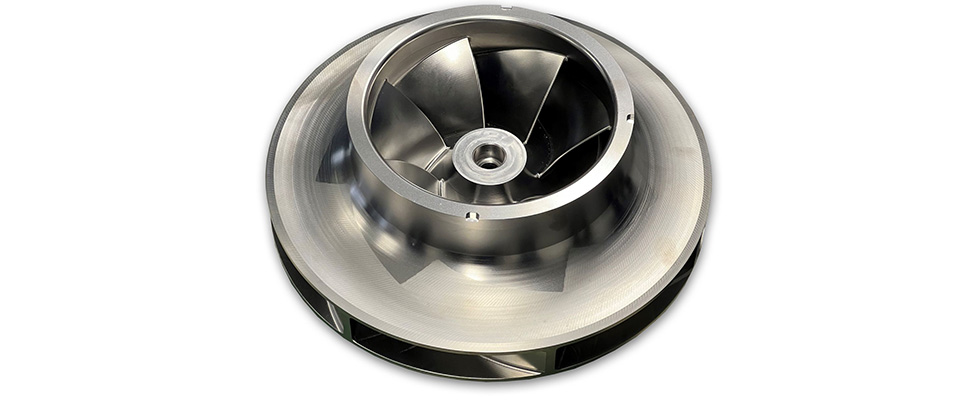

Laser powder bed fusion (LPBF), also known as selective laser melting (SLM), is used in the manufacture of spare parts, predominantly in gas turbines and pump parts such as impellers. This technology is especially suitable for working with metallic materials, resulting in high integrity, high strength and durable parts for corrosive and high-temperature environments. LPBF provides exceptional geometric freedom, enabling the precise production of complex parts required for high-speed turbomachinery in a toolless manner.

Complex impeller geometry (Images courtesy of Sulzer)

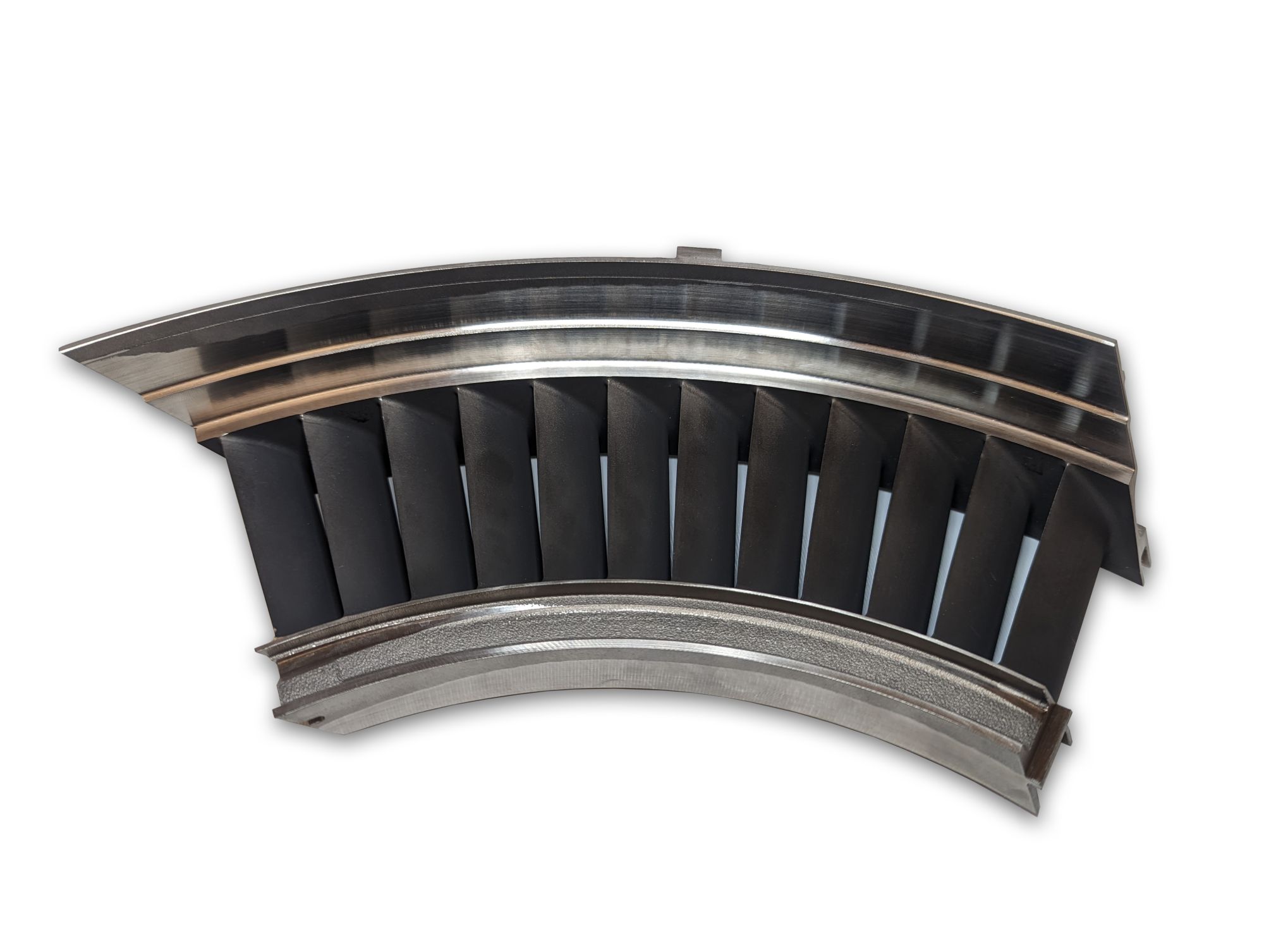

One of the challenges with AM is working in accordance with the list of materials that have been qualified and approved in industrial settings. Processes that use wire or powdered feedstock are continuously evolving to include new materials. For example, AM vanes made using IN738LC, a material complex by design, can withstand extreme temperatures in a gas turbine. As this process advances, the number of applications that can benefit from AM is increasing each year, and that trend is set to continue.
Qualifying complex materials such as IN738LC broaden the applications that can benefit from additive manufacturing.
IMAGE 2: Qualifying complex materials such as IN738LC broaden the applications that can benefit from additive manufacturing.
Using new materials to create parts that are better than the originals will most often improve reliability as well as efficiency, reducing energy costs and the carbon footprint of the business. Moreover, these parts can extend the periods between overhauls, further reducing the cost of ownership.
