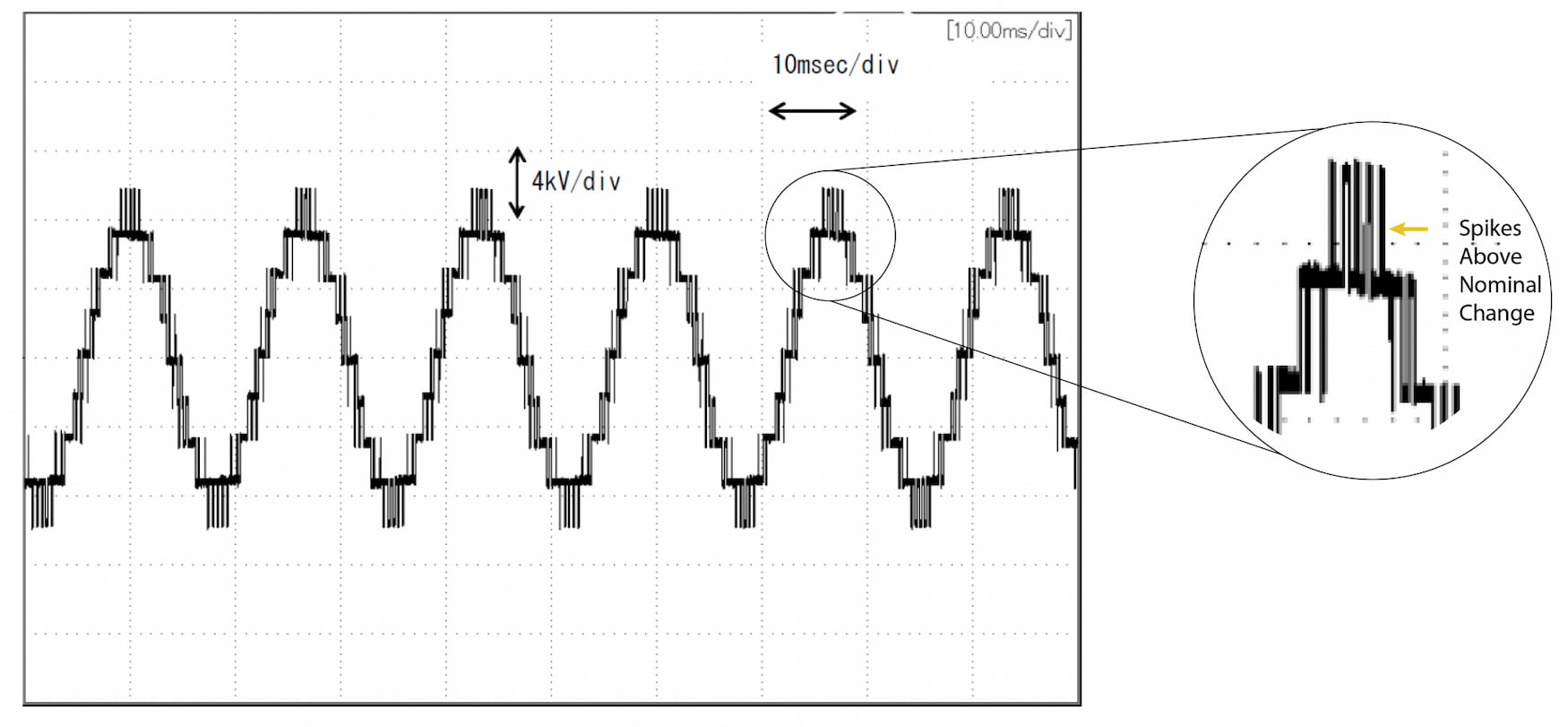

In this process, harmonic waves and short-duration insulation eroding voltage spikes are also generated in magnitudes dependent on the VFD’s carrier frequency and its circuitry, along with any included filtering, if required. The output voltage of a VFD is critical information for the motor manufacturer. The motor manufacturer should consider the VFD’s effects in terms of size, cost and the best motor-VFD performance. Here are key points to consider when designing a custom-made motor to operate on a VFD.

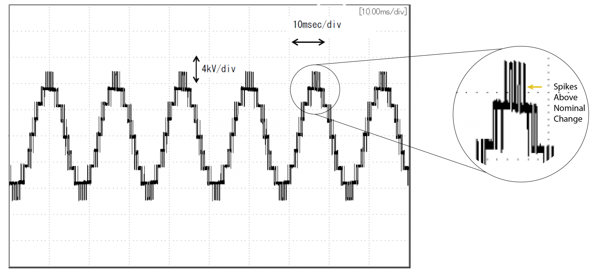

An output wave of a five-level 6 kV VFD (Images courtesy of TMEIC)

The voltage waveform supplied by VFDs consists of pulses with fast-rising peaks, behaving like surges in the connected motor winding. These differ from regular sine waves. The impedance mismatch between the power cables and the stator will augment the voltage by reflection. Over time, the stator insulation will deteriorate and fail if these fast-rising peaks are not addressed.
An actual waveform depicting the total harmonic distortion is valuable information but not always supplied, forcing the motor manufacturer to make assumptions. Over or underestimating the harmonics results in an additional cost to the user. In the absence of such data, a manufacturer may decide not to offer a motor due to the high level of risk.
