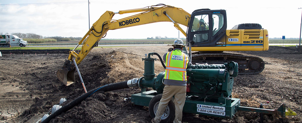

IMAGE 1: Neglecting to properly calculate NPSH or leave sufficient margin can result in pump cavitation and system failure. (Images courtesy of United Rentals)
