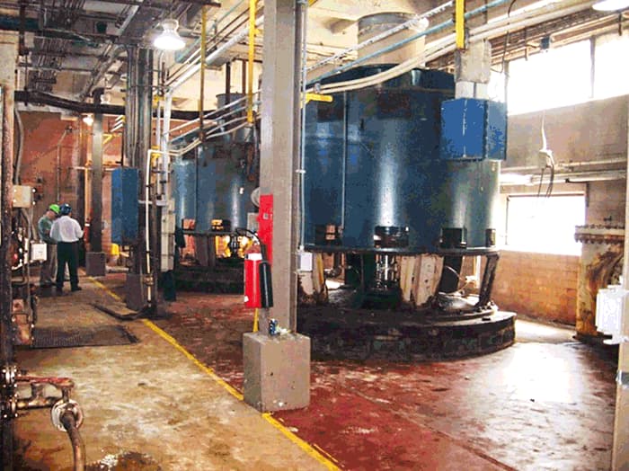

Image 1. Typical circulating water pump installationImage 1. Typical circulating water pump installation (Images courtesy of ProPump)
Compliance with EPA 316b can involve many solutions, including:
  • Modify circulating water pump design or operations: Throttling pumps (see Image 1), running fewer pumps, rerating one or more pumps

As a cost-effective option, some plants have considered throttling their circulating pumps as a means to lower screen velocity. But simply reducing flow rate by throttling, if achievable, results in other trade-offs. While throttling is cost effective to try (and is reversible), it must be evaluated for impact on unit heat rate and output. Using the pump discharge valves or condenser inlet or outlet valves to throttle also requires review of the valve design for throttling mode. These valves are usually butterfly isolation type and not designed for continuous throttling. Additionally, the circulating water pumps may not be candidates for long term operation at the lower flow rates due to their particular hydraulic design.
Partial throttling (i.e. more modest flow reduction, staying above the recommended minimum flow rate) may be more practical if combined with other options, such as cascading pumps (idling one in the winter) or traveling screen inlet area increase. Several sites with older, idle units have been studied. These idle units could allow refurbishment and utilization of their existing intake structures to increase screen area and lower intake velocities without the major expense of new screens or intake structures.
