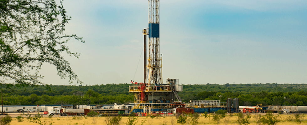

fracking oil rig
Rystad Energy estimates that to maintain flat production next year about 190 rigs will be needed in Permian.
Fracking operations are beginning to recover in the United States, Rystad Energy recently reported, because of an unusually high number of drilled but uncompleted wells (DUCs). This inventory is expected to sustain the current level of fracking without the need to add more rigs to expand drilling deep into 2021, according to the Rystad Energy analysis.
