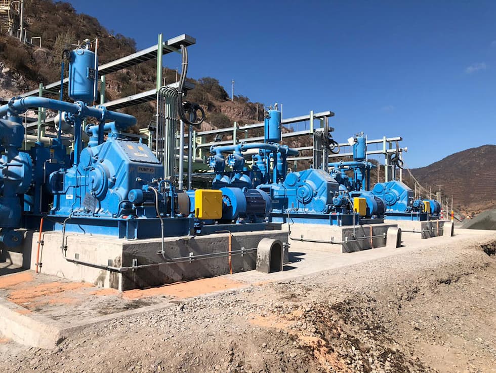

Piston-actuated quadruple diaphragm pump
How these pumps are able to operate at higher efficiencies and pressures.

 When the ability to drop a hose and use a gas-engine driven, end-suction centrifugal pump is not possible, users need an electrically driven, piston-actuated diaphragm pump as a permanent solution. These types of pumps do not have the same portability as kinetic pumps but gain the permanence of scalability, dependability and greater volumetric efficiency—on average, they have 90% overall volumetric efficiency.
Achieving Efficiency Within Budget
Piston-actuated diaphragm pumps used in mine dewatering have the ability to work at high pressures and efficiencies at a constant rate. They are easy to maintain and repair and operate at a slow stroke speed that is conducive to low vibration and parts wear.
Piston-actuated diaphragm pumps do not need a tight tolerance or clearance in the pumping chamber to operate and can pass thick slurries, sometimes as thick as up to 70% solids. Since they move a given amount of fluid or slurry for each pulse of the diaphragm, they can pump repeatable and reliable volumes almost every time. The fluid amount does not fluctuate much during pockets of migrating solids or gassing.
Most piston-actuated diaphragm pumps are run on a variable frequency drive (VFD) and have an adjustable operational range. They have passive pumping ability in which the fluid column passes by the face of the diaphragm and usually does not slam up against it. These types of pumps also require fewer booster pumps or no booster pumps in many mine dewatering operations when properly sized and used.
