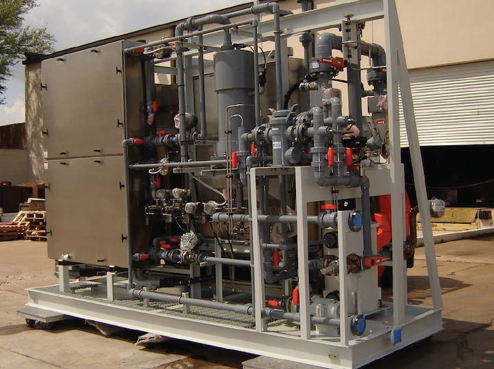

Maintaining a Seawater Electrochlorination System
A seawater electrochlorination system can last as long as 30 years or as short as one—it all depends on how well it is maintained. As the electrolytic cell is a significant portion of the system cost, it is important to have a solid cell maintenance protocol.
For maintenance, regular system monitoring is crucial, as well as following manufacturer maintenance guidelines. Maintenance is centered on keeping the electrolytic cells clean, and how often they will need cleaning will depend in part on specific site conditions.
For example, if a seawater electrochlorination system is located near other industrial operations, the seawater may have a higher content of iron or manganese. Also, salinity in seawater varies from location to location and will have a varying impact on how often electrolytic cells need cleaning.
Seawater electrochlorination system
For some systems, maintenance includes manually cleaning the electrolytic cell(s) with an acid wash. Acid washing requires the system to be placed out of service during cleaning. The used acid solution must then be neutralized or transported for disposal. Generally speaking, the cells are cleaned about once every month.
More advanced systems may include a reverse polarity mechanism that can safely clean electrode surfaces. Instead of using an external acid, the polarity of the current passing through the cell is reversed, so positive becomes negative and negative becomes positive. When this occurs, hardness deposits are dissolved from the surface of the electrodes, eliminating the need for external acid washing.
