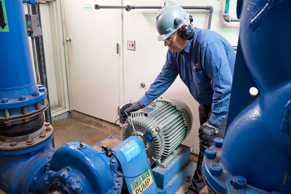

IMAGE 1: Faults in pumps can be detected months in advance. Using vibration or temperature data, users can identify trends that can be used to screen for potential problems. (Image courtesy of Fluke Reliability)

A user can be taught to screen vibration data from a portable hand-held vibration tool or a wireless remote sensor. There are also portable and wireless tools and sensors that are more sophisticated. They can be used to set up narrow band alarms.
Think about overall vibration as a broad band alarm—that is, users can set a band over a large band of frequency and then look at all of the vibration data.
To know what a specific fault pattern is, users need narrow band alarms, which look at smaller frequency ranges. By knowing where the frequency is and whether that fault is showing up on the motor or the pump, a user does not have to be an expert to find the four most common faults: imbalance, misalignment, bearings and looseness.
Tools can give an alarm when one of those frequency bands is exceeded, meaning a fault has been detected. That is why pumps are prime candidates for condition monitoring and particularly pilot programs: they follow predictable patterns.
