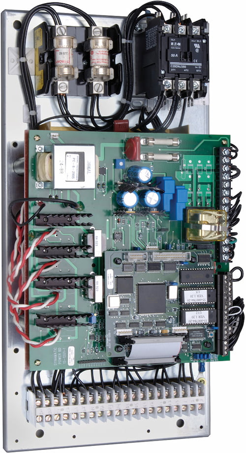

Older mechanical units are almost always repairable using widely available standard parts, such as ball bearings, carbon brushes, slip rings and speed feedback tachometers. Despite their long life of service, some controllers are vulnerable to failure and parts obsolescence. For a relatively low cost, the entire controller can be replaced. Modern adaptations of the controller can utilize the rugged and reliable silicon controlled rectifier (SCR) conversion technology to produce variable DC excitation from a single-phase AC input. This old-school technology is mated to a 21st-century digital-microprocessor-based control platform, giving this device a modern feel and far more flexibility than any preceding design. This makes possible a series of new features for the eddy current drive, like compact size, keypad monitoring and a single control platform..jpg)
