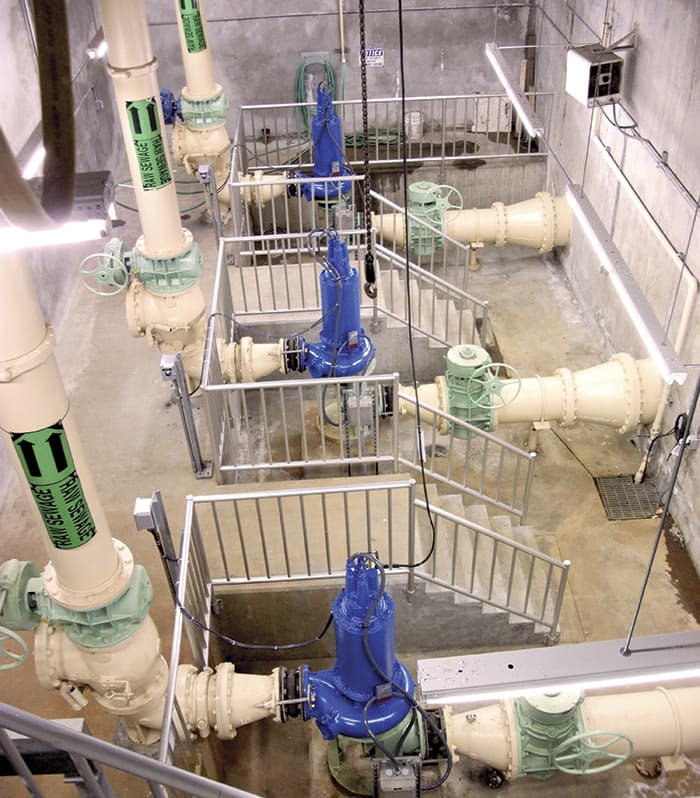

During the 2014 rainy season, a crucial influent pump station in the growing northwest city of Marysville, Washington, was at capacity for storm flows. Its three influent pumps needed to be upgraded to increase capacity. The existing 25-horsepower (HP) (18.7-kilowatt [kW]) pumps were barely able to keep up and overheated in maximum flow conditions. Facility managers determined that 38-HP (28-kW) pumps were the maximum size that would fit in the existing space and not exceed the motor control center (MCC) starter size. While these new pumps would provide the required flow rates for projected storm flows, the facility team was unsure if the existing standby 125-kW diesel generator would be able to run three 38-kW pumps. If direct-on-line starters (or even soft starters) were used, the generator would not be able to handle the inrush current.

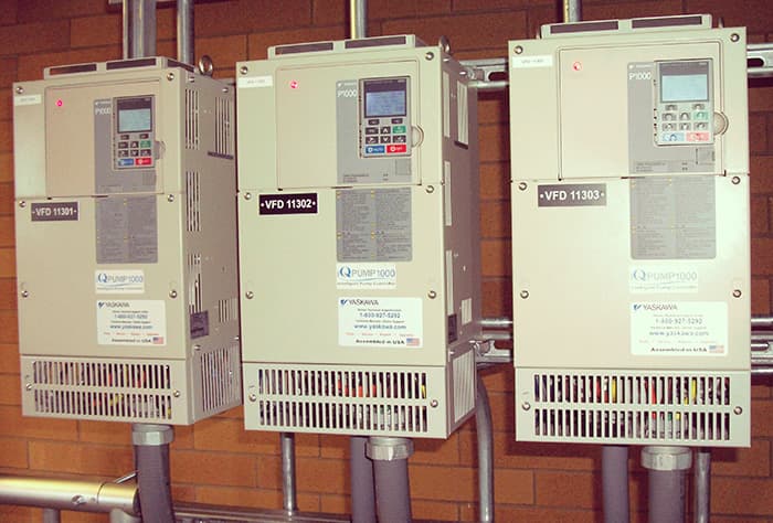

Because the facility did not have a budget for a replacement generator, the team decided to reduce the load on the old generator by incorporating VFDs.
In the last fiscal year, each of the three pumps was increased from 25 HP (18.7 kW) to 38 HP (28 kW), and the existing full-voltage starters were replaced with VFDs. Installing VFDs in place of the existing full-volt starters benefited the generator in two specific ways:
- Inrush current on pump start was reduced from 600 percent to less than 20 percent without sacrificing starting torque. Because a VFD starts the motor with design slip (nameplate slip), 150 percent rated motor torque is available at start.
- Maximum speed and associated kW load were easy to adjust downward.
Installing VFDs in place of full-volt starters also improves process efficiency.
Using a longer acceleration ramp minimizes surges in the influent filtration lagoon. The new pumps each increased the flow from the original 1,700 gallons per minute (gpm) to 2,500 gpm at full speed, 2,300 gpm at 95 percent speed and 2,100 gpm at 90 percent speed. Because the generator and regulator were older, 3 percent line reactors were added to the VFDs’ built-in 3 percent direct-current (DC) link chokes as a precaution.

Two tests were run to assess the impact of these changes. In the first test, all three pumps were engaged at 100 percent speed while running on generator power, and the total kW load was 86 kW (69 percent) of the 125 kW rated capacity. The total flow was measured at 5,100 gpm with the present total dynamic head.
While the pumps individually can produce up to 2,500 gpm, the piping system and influent tank level restrict the total flow. The PF was 0.93 DPF, and the total harmonic distortion (THD) measured 26 percent.

Prior to the generator excitation retrofit, the VFD speeds were limited to 90 percent. Even at 90 percent speed, the gpm was still 23 percent more than the old full-speed pumps, and the generator load was 75 percent of the new full-speed load (0.75 X 86 kW = 65 kW or 52 percent load). These conditions allowed for the additional harmonic heating in the generator until the retrofit could be accomplished.
The full-speed tests showed that operating all three pumps at full speed provides more flow than presently required. The VFDs have been dialed back to 88 percent max speed for normal operation, which will provide energy savings and reduced pump wear. The power utility is interested in doing measurements and evaluation for a potential energy rebate.
