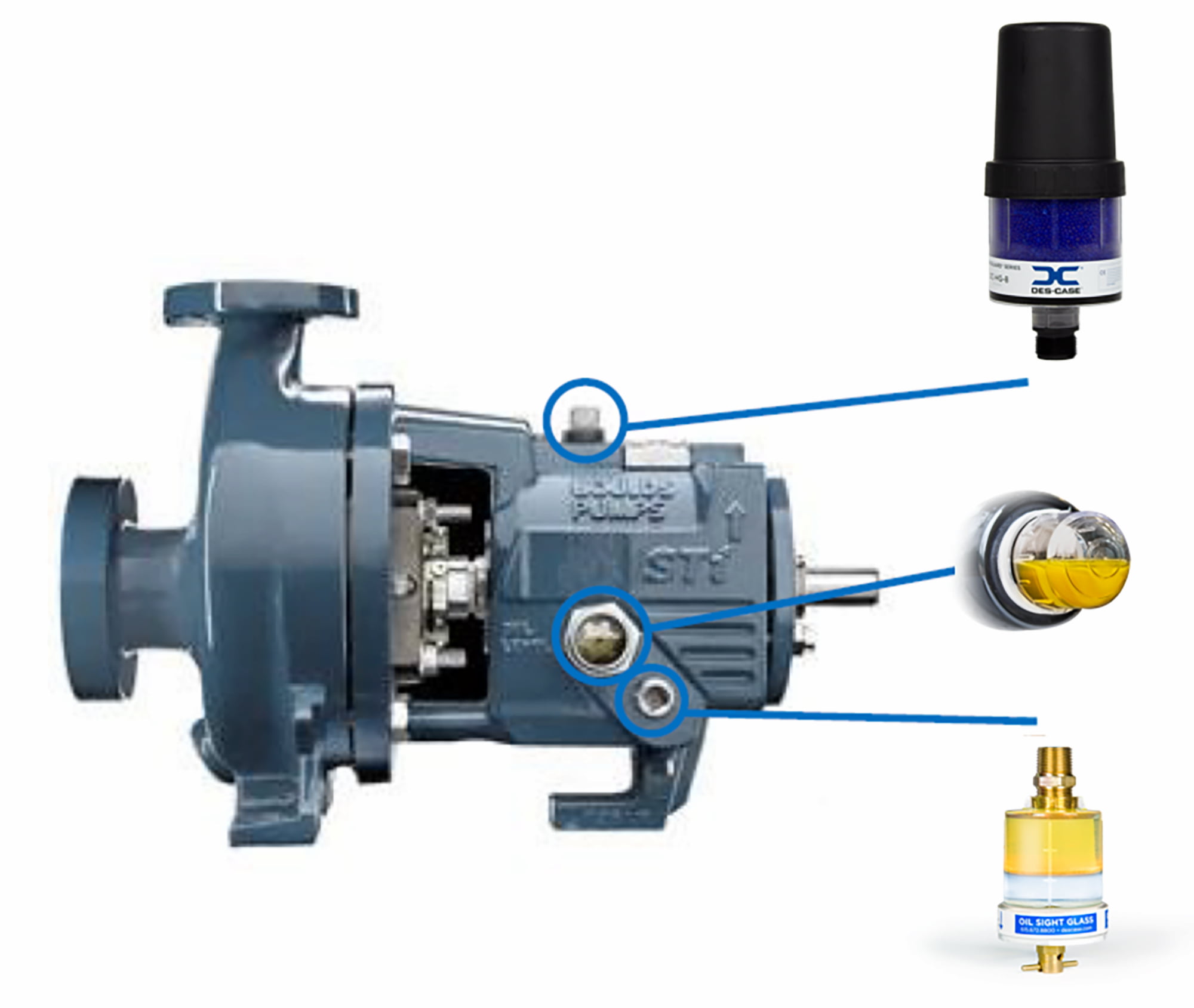

IMAGE 1: Ideal configuration for visually inspecting a pump (Images courtesy of Des-Case)

Unfortunately, many process pumps are not set up for visual inspections and must be modified to include simple hardware to permit key lubrication issues to be detected. The top image illustrates some simple, inexpensive hardware additions that greatly enhance the “inspectability” of a small centrifugal pump.
Once suitably modified for visual inspections, inspection routes and check sheets should be developed to check for the following:

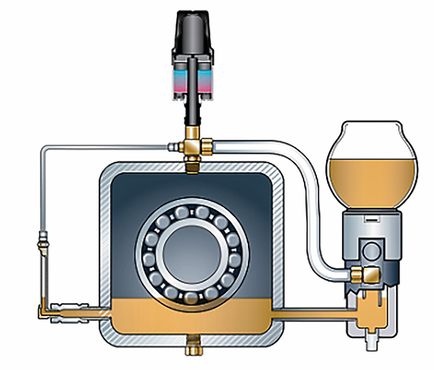

IMAGE 3: The correct oil level for a pump is halfway up the lowest rolling element.
IMAGE 4: The correct oil level for a pump is halfway up the lowest rolling element.
Oil level
Proper bearing lubrication requires that the oil level be maintained halfway up the rolling element in the oil sump (Image 4). If it is too low, lubrication starvation can occur. If it is too high and churning, increase in temperature and aeration can occur. For smaller pumps, this can be a challenge since some ball bearings can be as small as a half-inch, meaning controlling oil level to within ±1 inch. Most pumps are equipped with a level plug at the correct level or a flat-face bullseye. Flat-face bullseyes work well when the pump is new and in good lighting conditions. However, over time, flat-face bullseyes can become stained or opaque, making oil level checks challenging. Instead, pumps should be equipped with a 3D bullseye that can be viewed more easily and is less prone to staining. Under no circumstances should a constant level bottle oiler be used to gauge if the pump is properly filled. The feed tube from the oiler to the pump can become plugged such that the bottle oiler can sometimes be full of oil while the pump is running on empty.

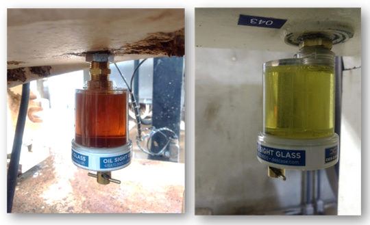

IMAGE 5: BS&W bowl showing clear oil discoloration
3. Oil Color
Whenever oil degrades, the color and clarity of the oil can change. While a change in oil color is not always indicative of a serious issue, a sudden change as shown in Image 5 should be reason enough to further investigate with oil analysis. BS&W bowls and 3D oil sight glasses are both great ways to visually observe and record oil color.

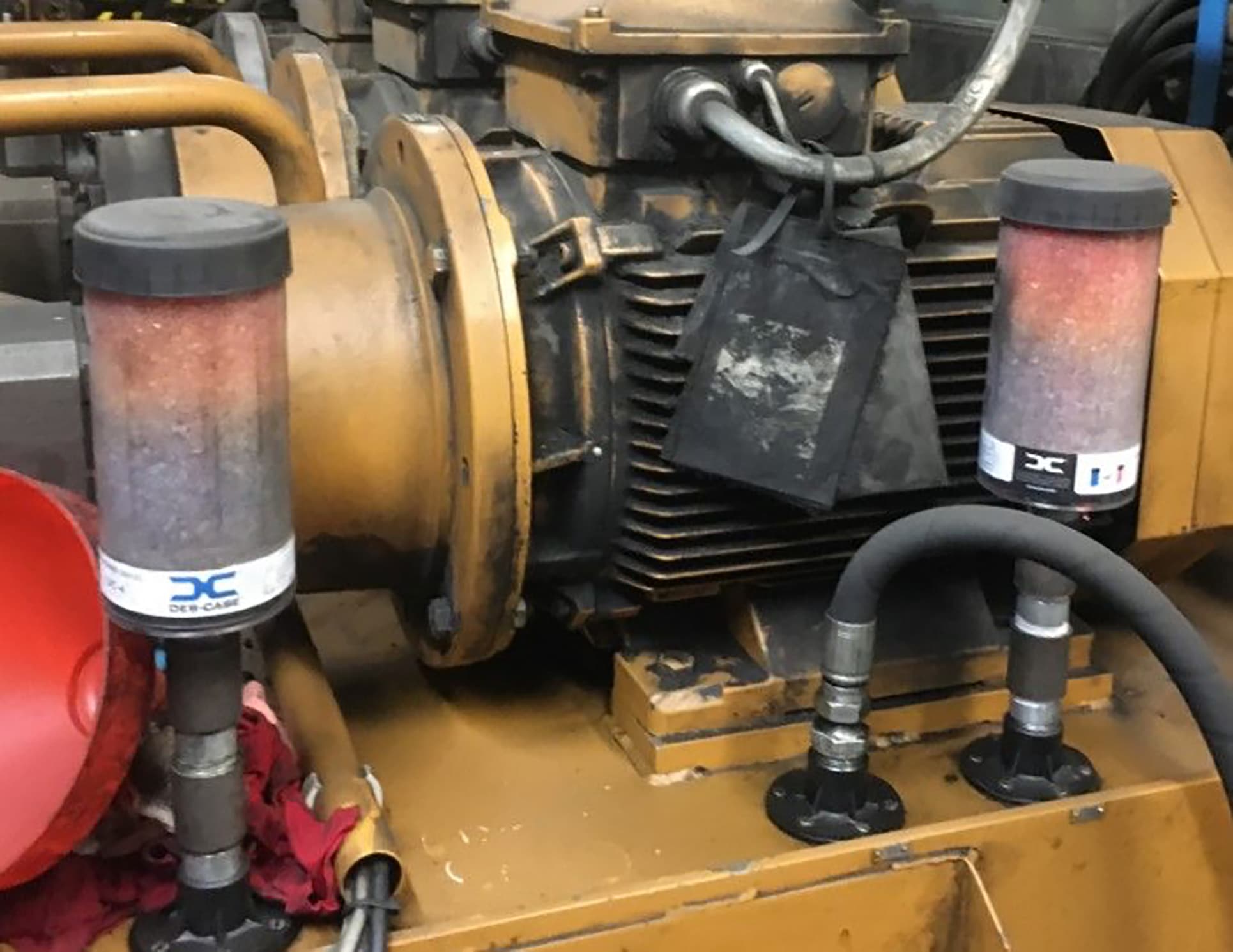

4. Desiccant Breather Inspections
In a previous Pumps & Systems article (“The Impact of Water on Pump Bearing Life,” August 2021), the author discussed the importance of controlling headspace humidity inside the bearing housing using a desiccant breather. However, a desiccant breather is more than just a means of preventing water from getting into the pump. It can also serve as another visual inspection point. Because of the way air flows through a desiccant breather, the color indicator, which turns from blue to pink when saturated with moisture, will change color from the bottom up or top down, depending on circumstance. A color change from the top down indicates that water is present inside the bearing housing, likely from seal failure (Image 6).

IMAGE 6: The direction of color change from top to bottom indicates internal water is present.
