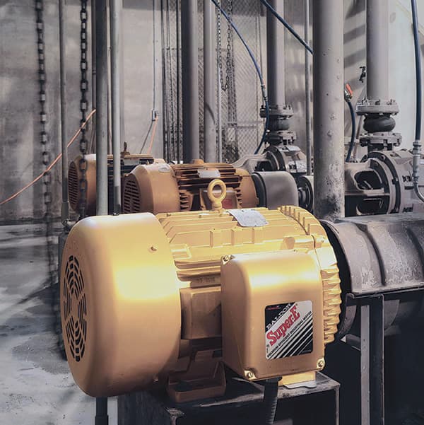

Pumps that move numerous required liquid products are present throughout manufacturing facilities, and a large number of them are driven by electric motors. Many parts of a food processing plant are considered dry zones. In dry zones, open drip-proof (ODP) pump motors are suitable as long as they do not require cleaning and remain free from moisture or exposure to outside environments.
Another common motor seen in other locations—such as a boiler room, a fluid pumping station or perhaps in the on-site water treatment area—is a totally enclosed general purpose motor. While not equipped to handle the harsh and direct spray used in washdown areas, these general purpose motors perform many tasks nicely without the need to upgrade to a fully protected washdown motor. Water or moisture may be present in other areas in which the equipment does not directly contact the food. For instance, some electric pressure washer systems use a totally enclosed general-purpose motor to drive the pump. Although these motors may experience some mist or humidity, if they do not have spray directed at them, a washdown motor may not be required.
