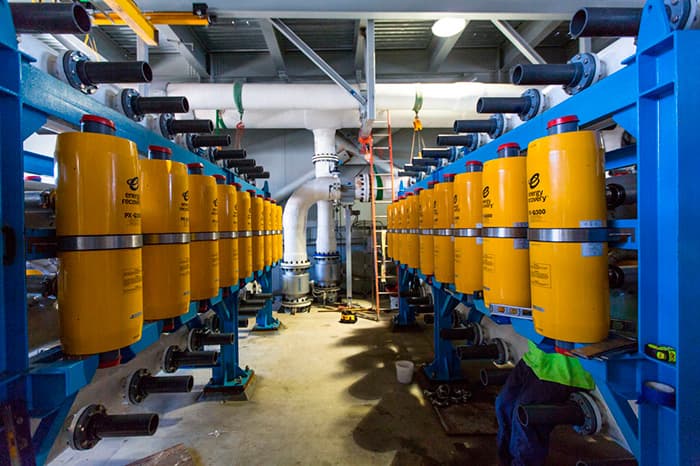

Image 2. The Carlsbad Desalination Facility uses 144 energy recovery devices that recycle the pressure from the reverse-osmosis process and save an estimated 146 million kilowatt-hours of energy annually, according to the plant's operators.Image 2. The Carlsbad Desalination Facility uses 144 energy recovery devices that recycle the pressure from the reverse-osmosis process and save an estimated 146 million kilowatt-hours of energy annually, according to the plant's operators.

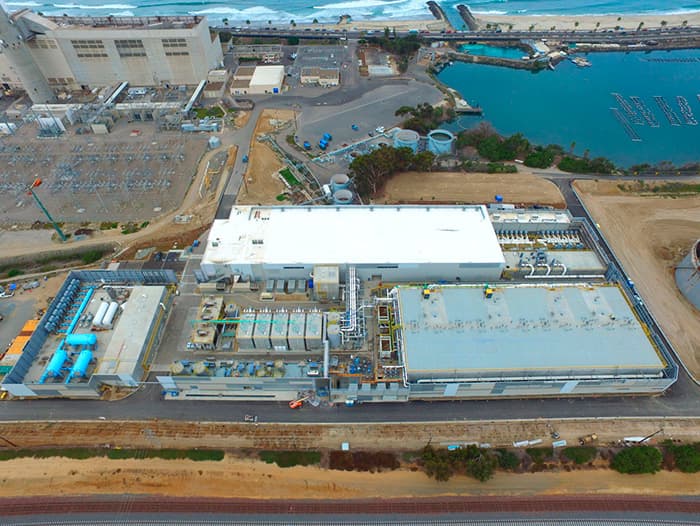

Image 3. An aerial view of the Claude Image 3. An aerial view of the Claude "Bud" Lewis Carlsbad Desalination Plant shows the facility that produces more than 50 million gallons of drinking water a day for the San Diego County area in Southern California.
