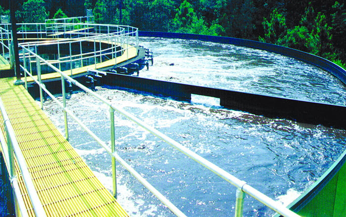

Image 1. Aeration basin (Image courtesy of Hydraulic Institute)HI and Pumps & Systems recently launched a training center to offer users a resource for technical solutions. Visit this new area for standards, webinars, certificate programs, training modules and more.
