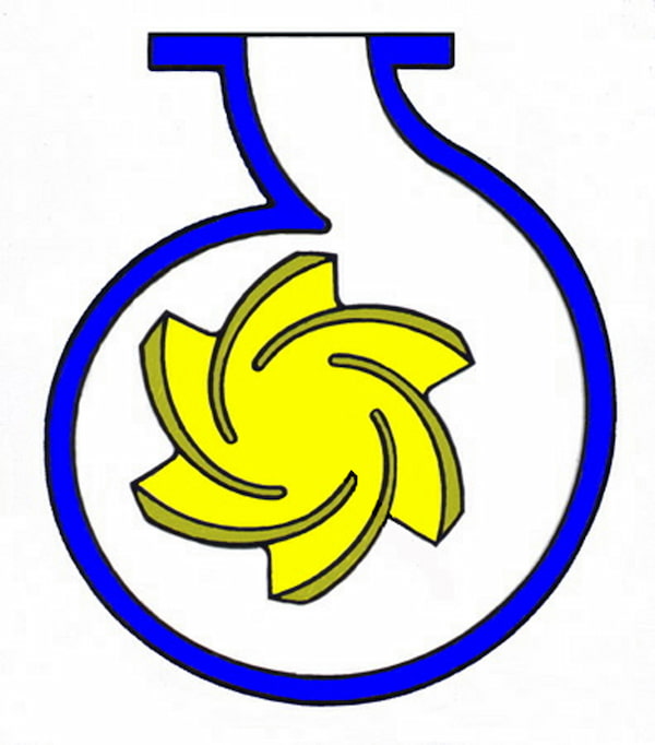

Most ANSI pumps, and some API pumps, employ a single volute design in the interior passages of the casing. This is particularly evident in the smaller sizes that involve low flow rates and lower specific speeds of the impeller.
As shown in Figure 1, the area of the volute increases at a rate that is proportional to the rate of discharge from the impeller, thus producing a constant velocity at the periphery of the impeller. This velocity energy is then changed into pressure energy by the time the fluid enters the discharge nozzle.
Figure 1. Single Volute Case
The peculiar shape of the volute also produces an uneven pressure distribution around the impeller which, in turn, results in an imbalance of the thrust loads around the impeller and at right angles to the shaft. This load must be accommodated by the shaft and bearings, and much has been discussed on this problem in recent years.
This load is at its maximum when the pump is run at the shutoff condition, and gradually decreases as the flow rate approaches the B.E.P. If the pump operates beyond the B.E.P., the load increases again, but in the opposite direction on the same plane. Examination of the resultant shaft deflection problems has indicated that the radial plane on which the out of balance load acts is approximately 60-deg counterclockwise from the cut-water of the volute.

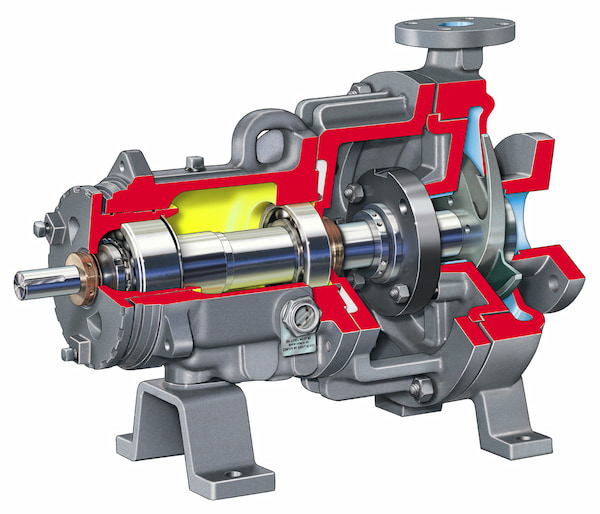

Figure 3. Typical ANSI Pump  Courtesy of Flowserve Corporation
In the ANSI design shown in Figure 3, the back cover and gasket is held against the pump casing by the bearing frame adaptor, which is most frequently supplied in cast iron. This usually results in a gap between the mating faces of the frame adaptor and the pump casing that has the potential to permit uneven torquing of the bolts. This may cause a fracture of the adaptor in the event of a higher than normal pressurization of the casing by the process system.

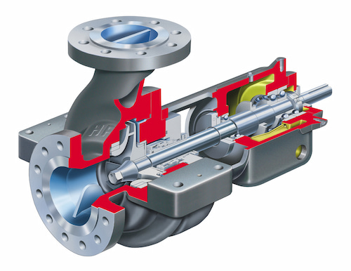

Figure 4. Typical API Pump  Courtesy of Flowserve Corporation
The API design in Figure 4 bolts the back cover directly to the casing and uses a confined, controlled compression gasket with metal to metal fits. The adaptor is bolted independently to the back cover and does not play a part in the pressure boundary of the pump casing.
