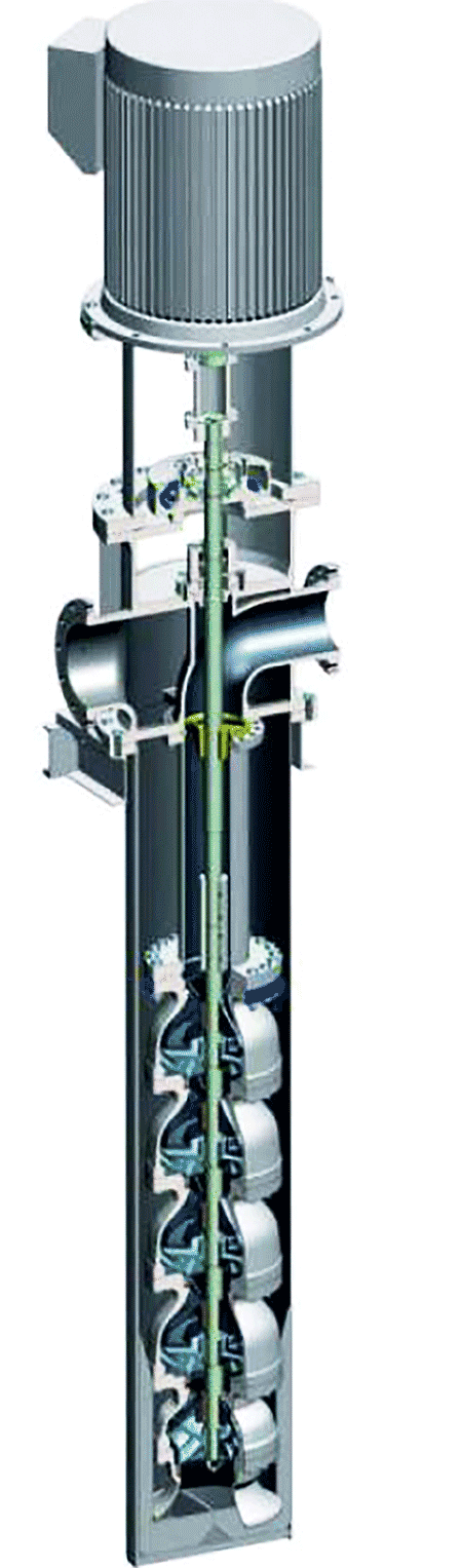

Vertically suspended suction can pump (VS6 type)
IMAGE 1: Vertically suspended suction can pump (VS6 type)
Image 1 illustrates a VS6 pump type that is typical of the types used for condensate in power generating plants. Additionally, a VS7 type could be used, which has a double suction first stage impeller that will have lower NPSH requirements for the same flow rate and rotational speed. It is possible for an end suction or between bearing pump to be used if the hot well level provides sufficient NPSH for the pump design.
