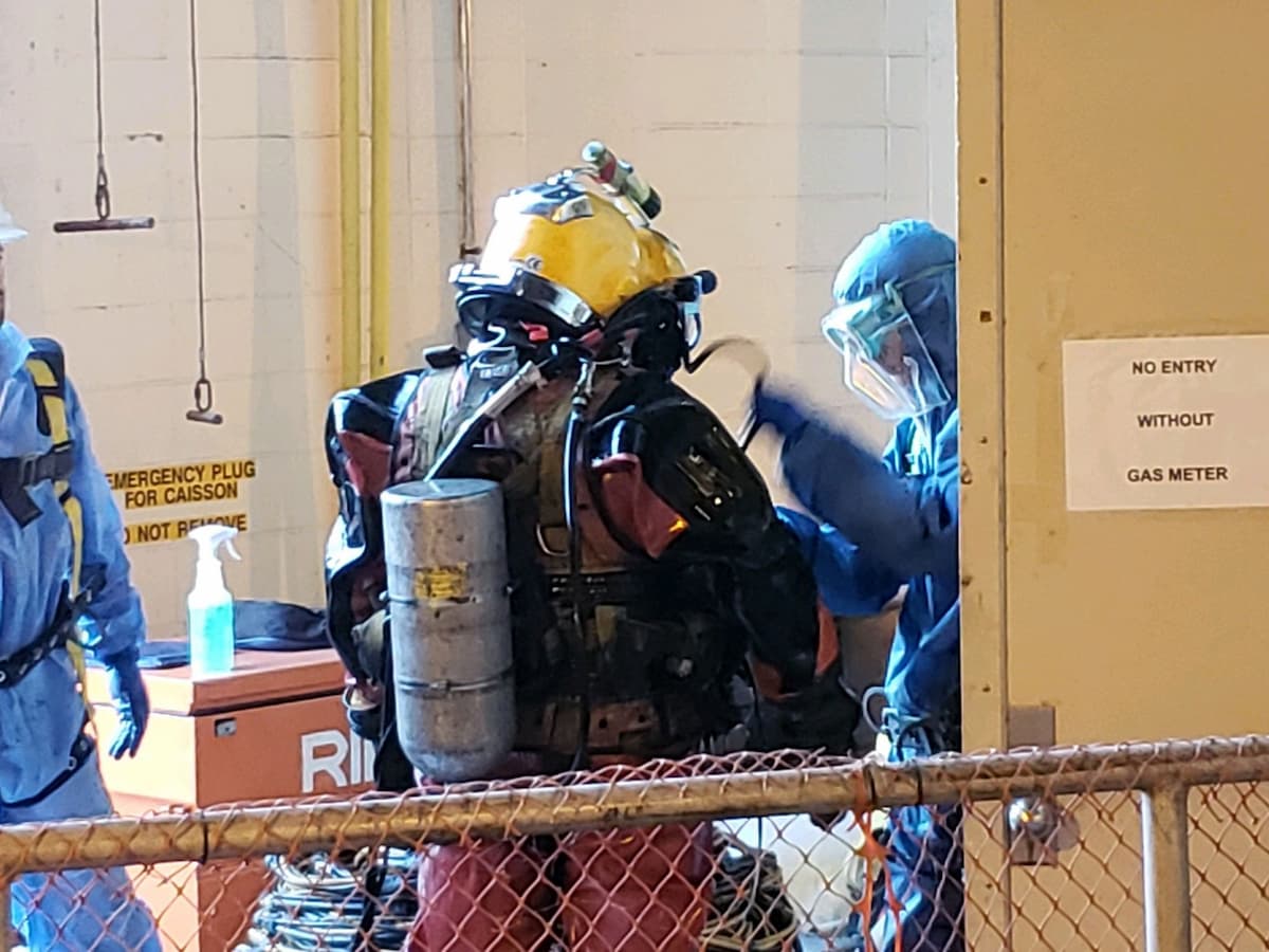

Divers retrieving clogged wipes from the Charleston wastewater system
In 2018, staff ran a social media campaign with photos of the clogs and the divers who unclog them by hand that went viral globally, reaching more than 1 billion people. “Unfortunately, what wasn’t significant was the impact on the amount of wipes that we saw in our collection system,” Public Information Administrator Mike Saia said. “We didn’t see any change whatsoever in the volume of wipes that we were getting on screens and taken out of the wastewater treatment process.”
